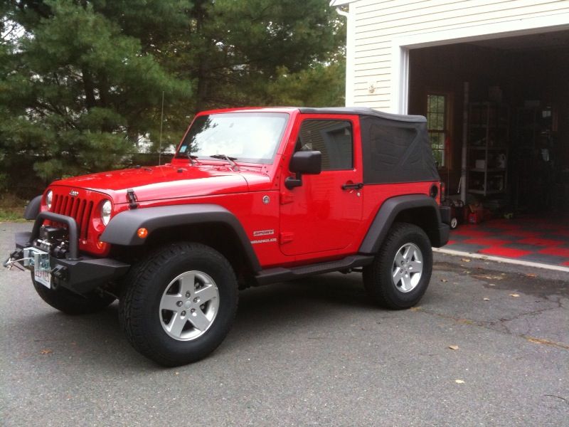

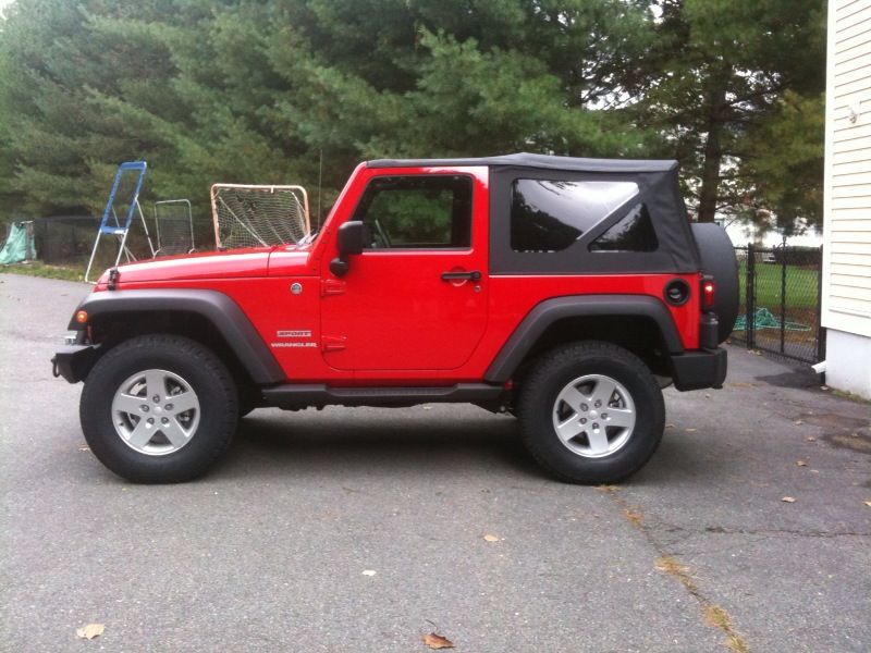

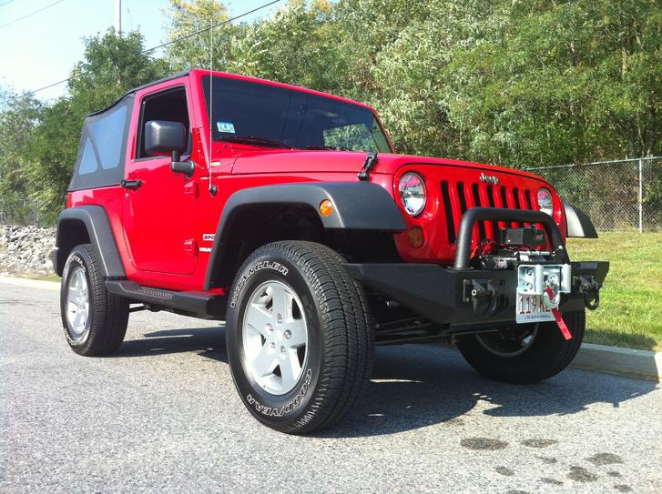

Default heres mine with 17 inch stock rims and new tires 285/70/17
heres mine with at 1 3/4 inch daystar comfort ride lift with scorpion shocks. rugged ridge front winch with a 8000lb winch.
