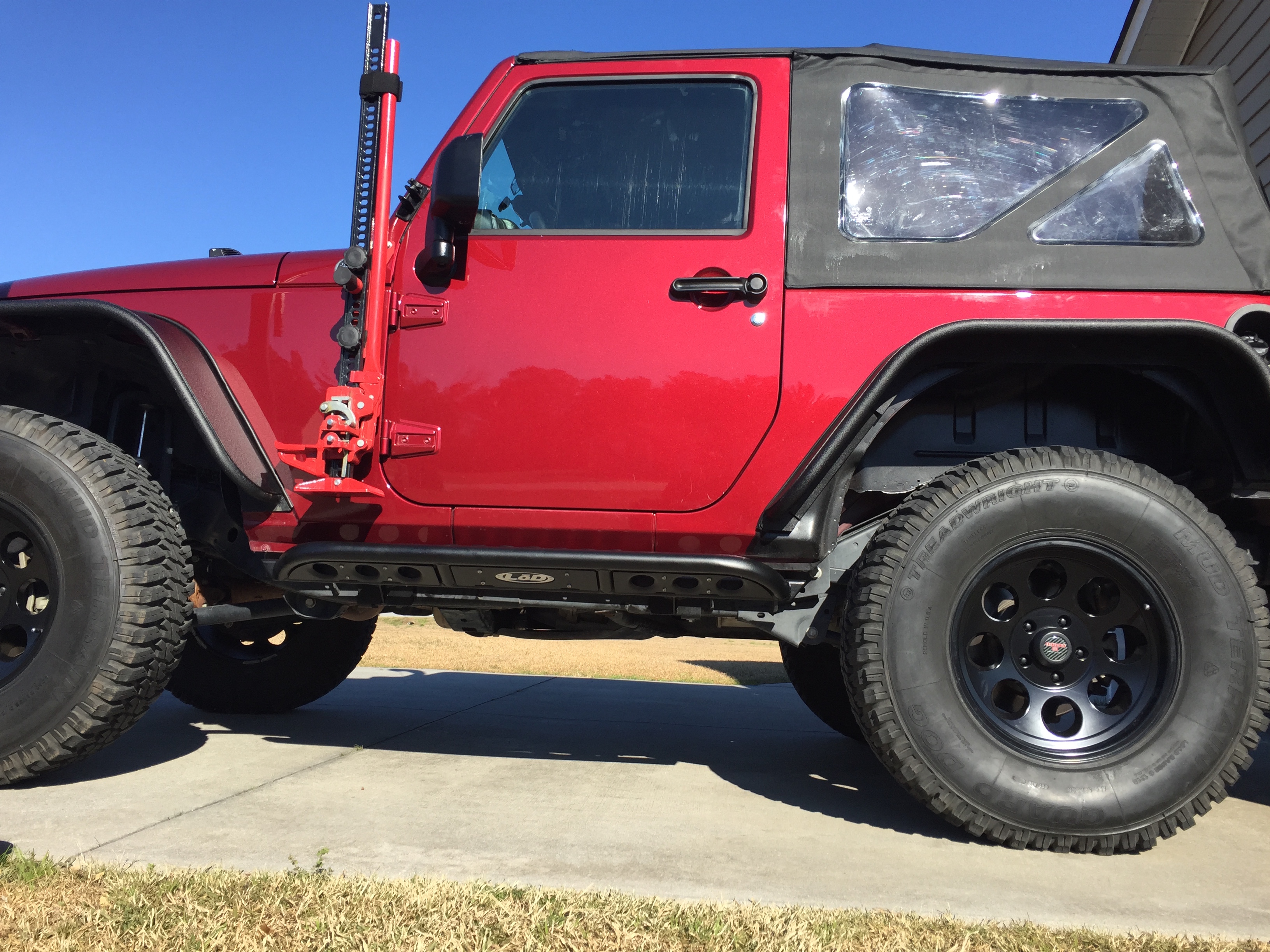

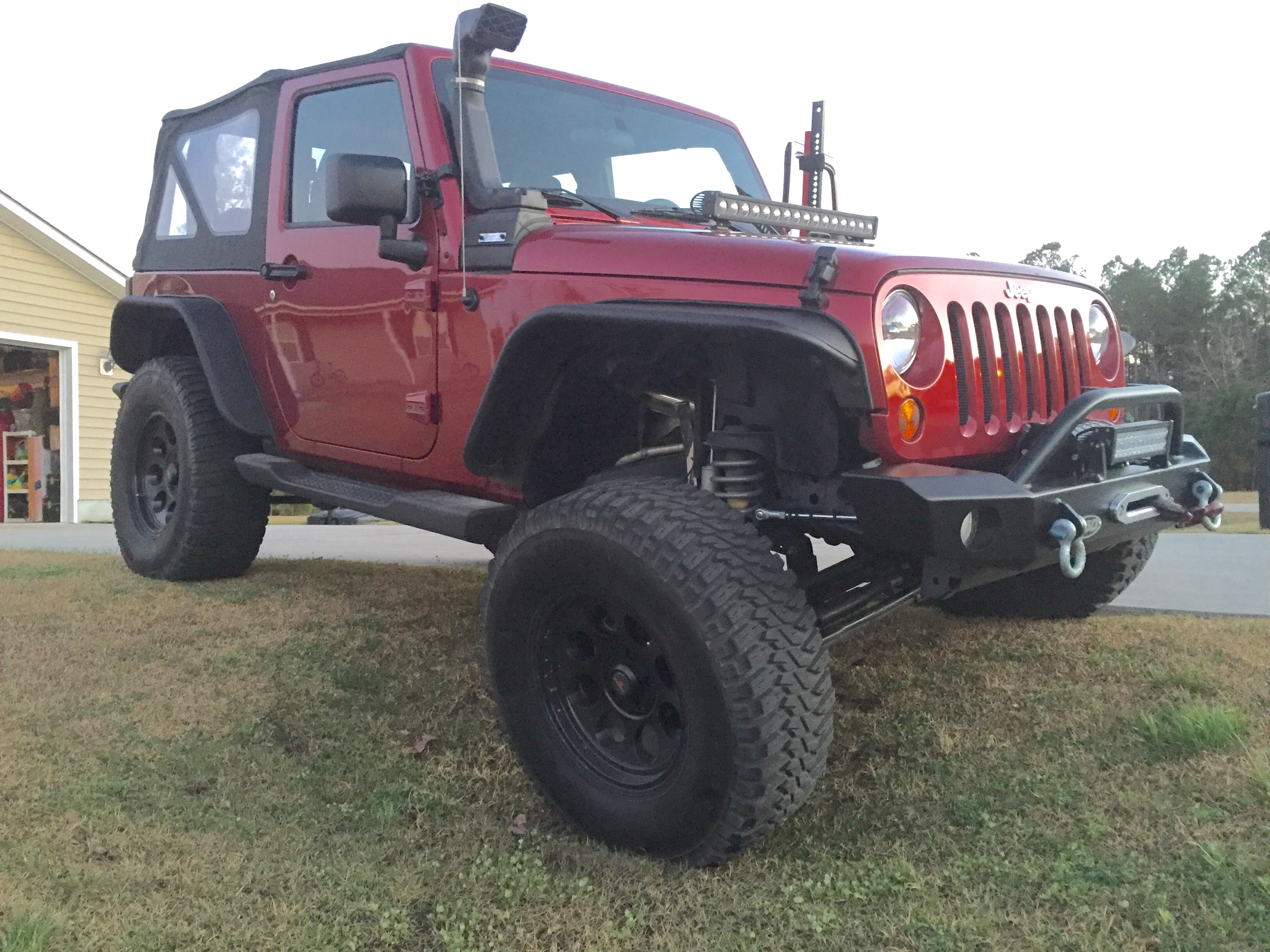

I say get the kit you want. Don't worry about the Kids. They will grow up and learn how to climb. Believe me my kids love my Jeep and I have a 2 Door with 2 boys. I think the general consensus on here is 2.5" to 3.5" is good height increase with these you can run 35's, 37's or larger if you run metal cloak fenders.
