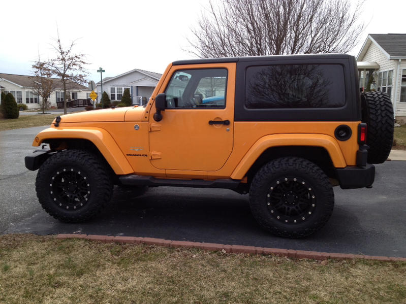

Teraflex level kit on 285/70/17 Nitto TrailGrapplers

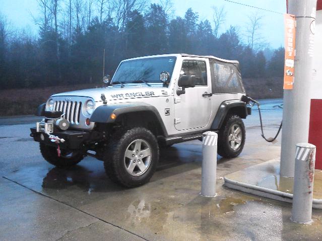

teraflex leveling kit here with Monroe reflex shocks and 285s here to. awesome combo...very cost effective and useable.

How many inches did u guys go?

The teraflex leveling kit gives 2" up front and 1" in the rear, I gained a little more total lift front and rear but it works perfect. Best leveling kit out there as far as I am concerned.

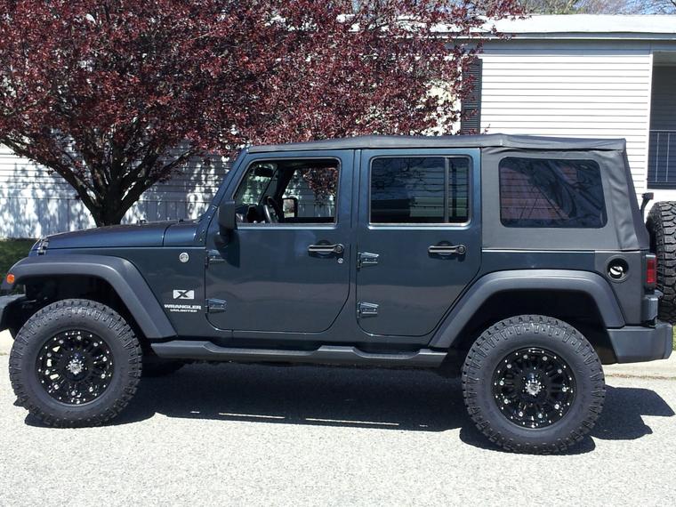

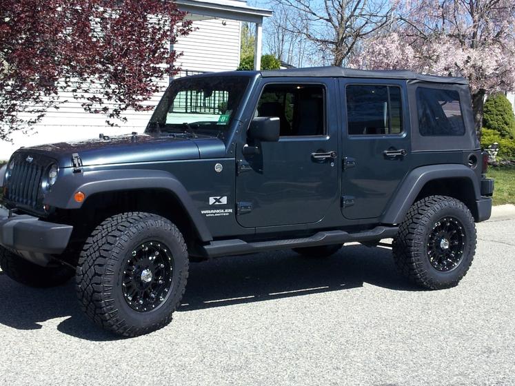

Spacers should not effect ride. Now I added spacer leveling kit with higher rate of springs and replaced my sport shocks with rubi's. Love it! I am not running 285's just 255's for now. Should be no problem running 35's down the road. Everything I installed was purchased slightly used on forum. Very cheap.
