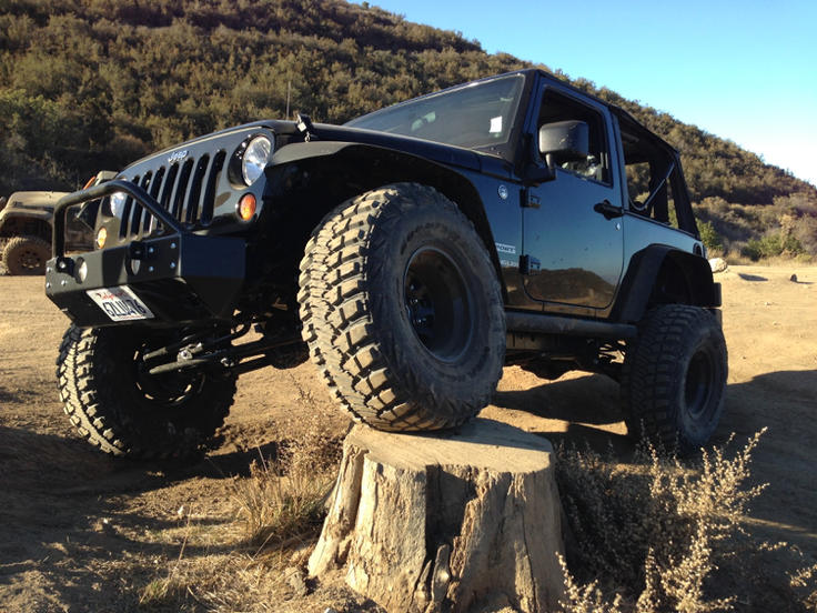

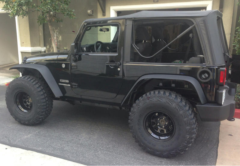

I'm running a 2" in the front w/o the isolator and 2 stock isolators in the rear (3/4")... Perfectly level.
Note I'm also running 18/60 coils which gave me 2 more inches
2013 Wrangler Sport; 35x12.5R15 Goodyear MTR's; 18/60 Rubicon springs & shocks; Lots of trimming
