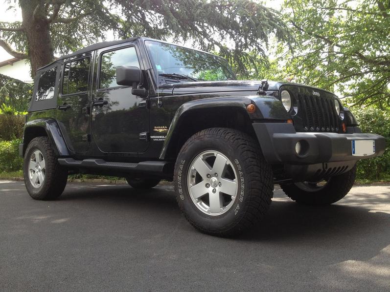

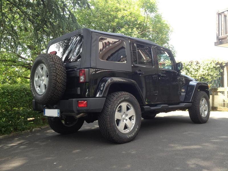

Here is mine with Teraflex BB Levelling kit, Grabber AT in 275x70/18 (33x10,5) and 1,25 wheel spacers...
