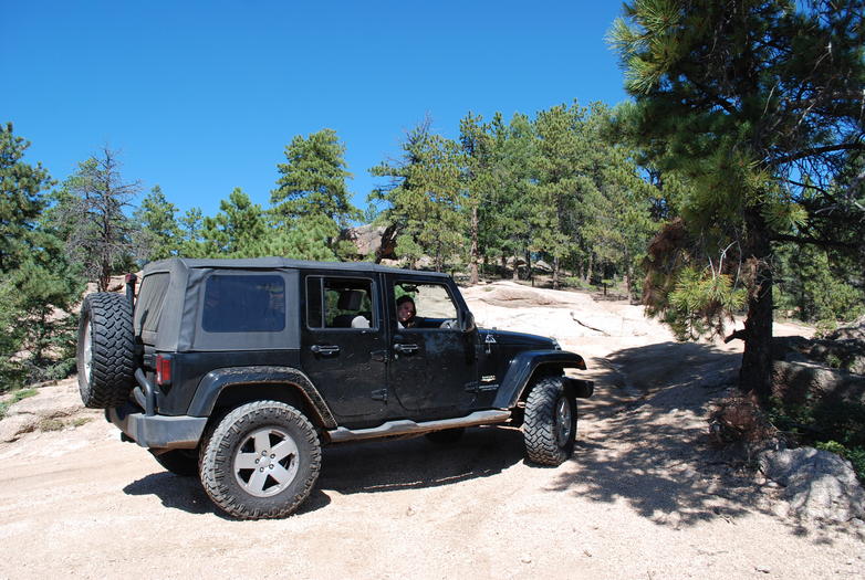

I have the specs below.. if I could change one thing, I'd bought the Bilsteins or the Fox shocks in lieu of the TF 9550s.. however, I love the coils over the BB, but thats me. TF has a great reputation, but you'll hear that about all of them. Here's a pic to help the decision...
ID:	270575Click image for larger version
