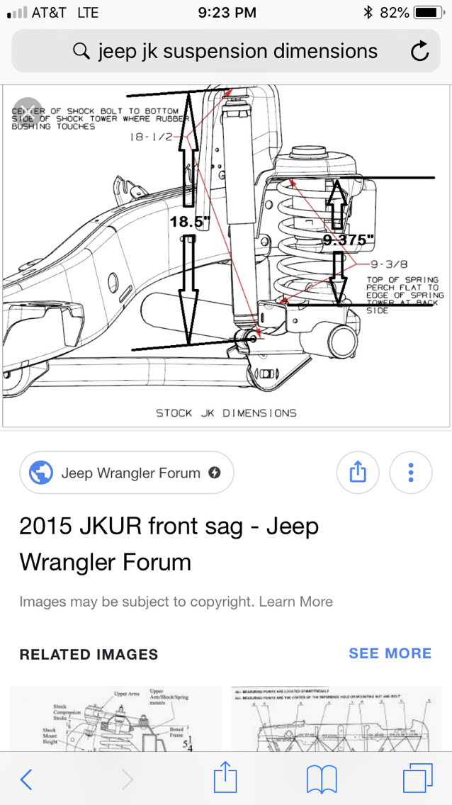

these are the best measurements I have found for stock in the front. Have t been able to find as consistent of numbers for the back. Comparing actual lengths in the back the shocks are very similar across the loft heights, at least with bilstein. The front is more important.
