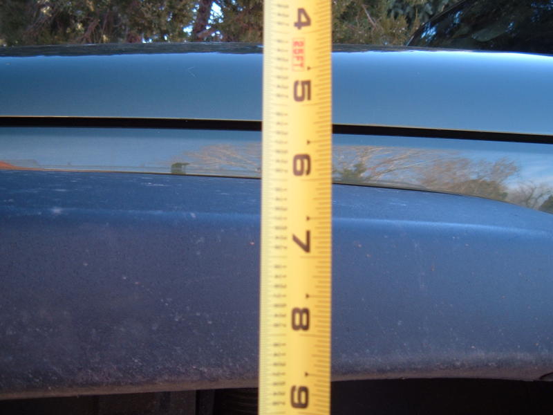

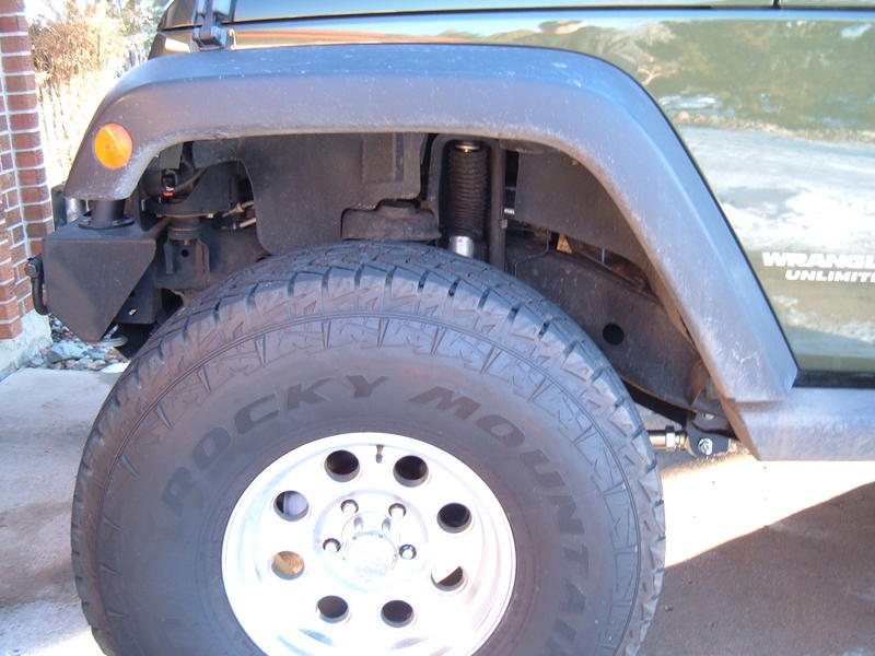

There ya go. Center of hub to top of fender with MC 3.5" coils...
Name:	height center-wheel.jpg
Name:	Height to flare.jpg
35 - 6.5 = 28.5 ?
