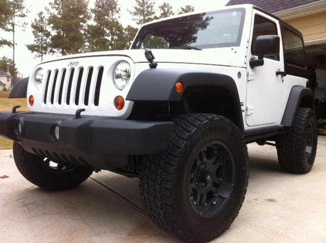

Old Nov 11, 2011 | 04:30 PM
MossGaBoss's Avatar
Posts: 84
From: Newnan, Ga
Default 2.5 Teraflex with shocks 325/60/18 tires
Originally Posted by 09RubiGirl
Thanks for the help! Any pictures so I can see what it will look like? Total newbie here.
This looks pretty cool I think.....but I like the wide tiresClick image for larger version
