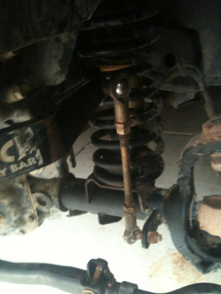

is that look right to just undo? and is there a way to change the stiffness of the sway bar? or is it set to one setting?
I don't think they are adjustable but yes that is the link you disconnect. You can undo them from the axle and wire tie them up or remove both ends. Make sure the bar ends are secure to and won't fall in the way. I don't know how much more flex you will get but there should be some more with it disco'd.
If you like it disconnected I would find someone who wants one and trade for their stock parts. Then buy quick discos.
