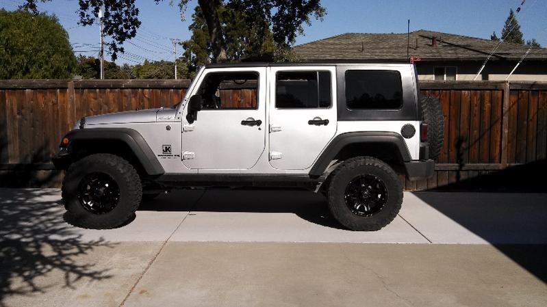

Get a set of 2.5 coils from teraflex and be done with it. you can sale the pucks on the forum. I have the teraflex 2.5 coil lift with 1" pucks all around because i have a 80 lb.wench and bumper up front and a 97lb.toyo mt on the back.
Good luck
