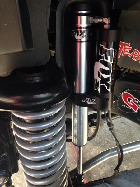

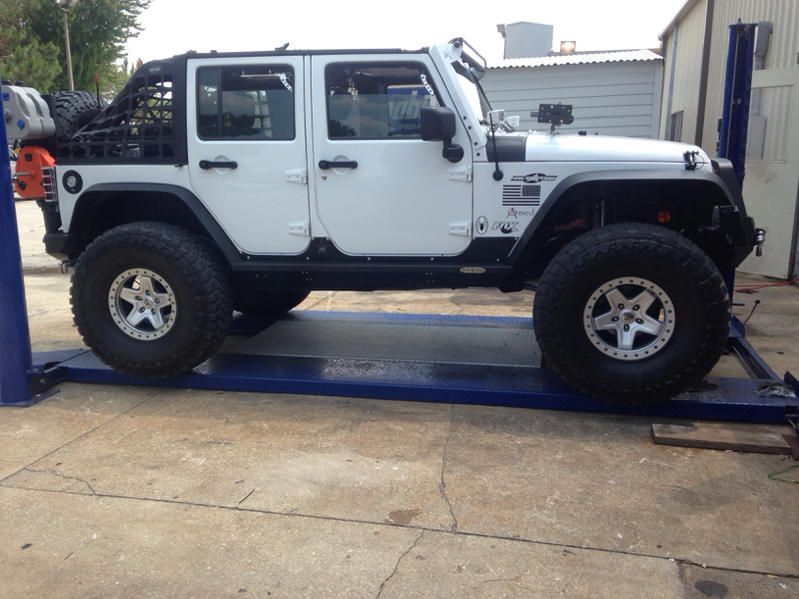

Love my Rubicon Express 4.5" super flex short arm lift. Very complete lift kit, 1ton drag link flipped-stainless brake lines etc.. Used Fox factory series shocks. Added 1" spacers to help with extra weight of bumpers/winch etc. rides great with the 40" MTs
