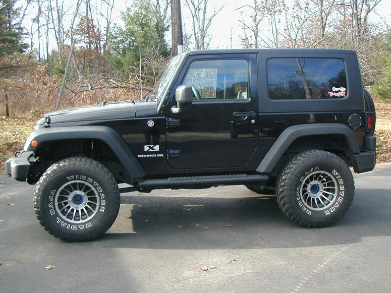

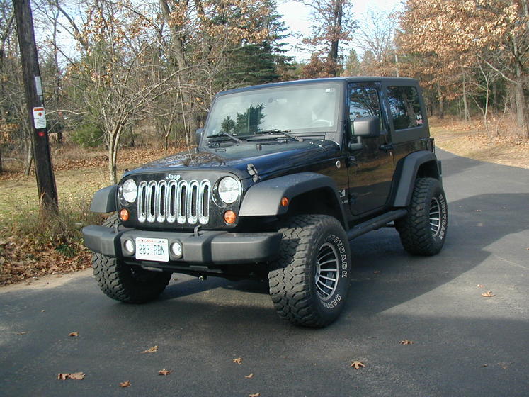

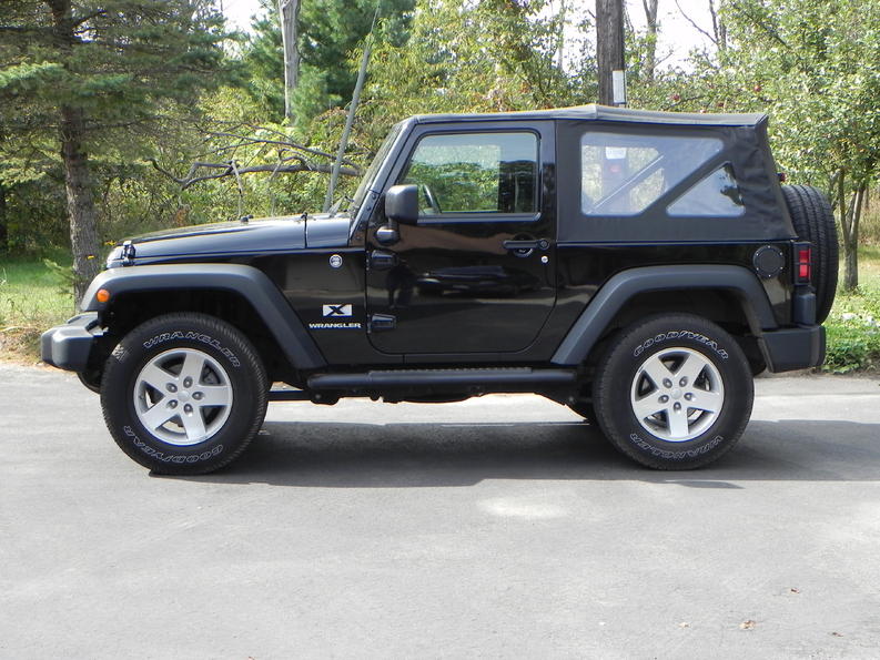

Here are pictures of my JK...before and after the Teraflex 2.5" Budget Boost with stock shock adapters, she is also wearing 33x12.50x15's....just to give you an idea of looks. The tires stick out a little, but that is because of the rims and the spacers.

Actually that's perfect! That's almost exactly the look I want. If you don't mind me asking, what all did you use? It's not too high and also doesn't look like a short fat kid. My cousin is supposed to come down from Cleveland next weekend and help me do it. I'll order all the parts this week if you don't mind me copying your build. Sorry, i wanted to clarify. What spacers and shock adapters did you use? I like the look of the tires sticking out too.

I got the best price on the stuff - I checked eveyone - from 4WD.com - Bustabizz on here. He can copy my order ticket for you. Service was great and delivery very timely.
- Teraflex 2.5" Budget Boost, comes with rear track bar adjuster and the shock adapters, everything you need is included, swap the rear sway bar adapters to the front is all (i got stumped on this at first)
- JKS Adjustable Front Track Bar
- Spider Trax Spacers
Install was a piece of cake, although I had my mechanic help me because we used his garage and lift.
Let me know how it turns out.
