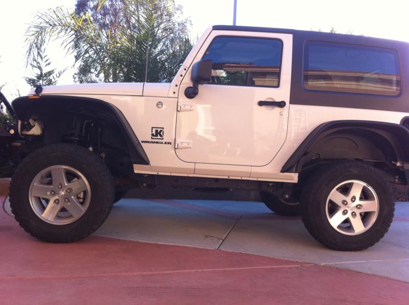

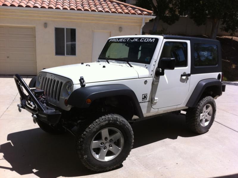

I lifted first, then put tires on second.
Here's two pics, one with the regular fenders, one with flats. I went more than 2 months till bigger tires too
ID:	142095   Click image for larger version
