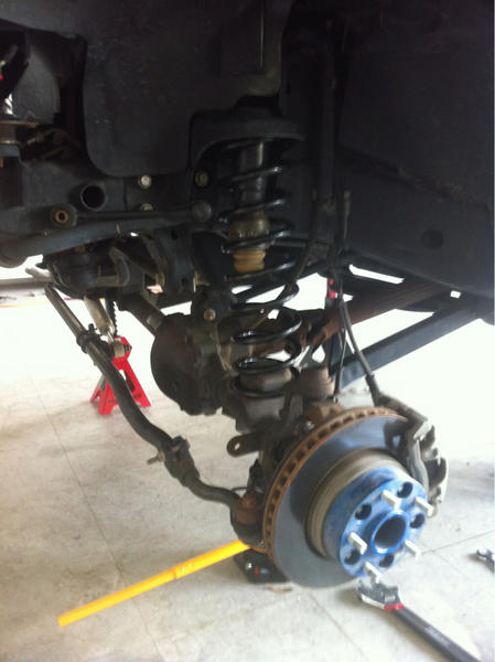

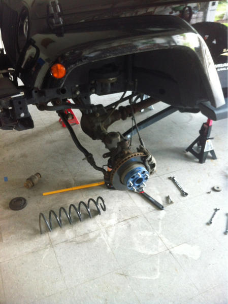

My best advice is make sure you have the right tools for the job and this will go smoothly. A set of ratcheting wrenches helps tremendously and have a breaker bar on hand to give you some leverage in case some bolts are stubborn. I also used a bottle jack to help remove the springs easier by wedging it between the axel and frame and slowly and carefully pushing the axel down to allow the springs to be removed easier. Make sure you watch your brake lines but they have a lot of give so it was a big help doing this by myself. I also used the dish washing soap on the bump stops to help get them seated. I took a 6 or 8" socket extension and put the biggest socket on it to provide a base and then used the other side to help push up the bump stop into place while I jacked the axel back up pushing it into place. Others have used blocks of wood I used what I had on hand and it worked great.
