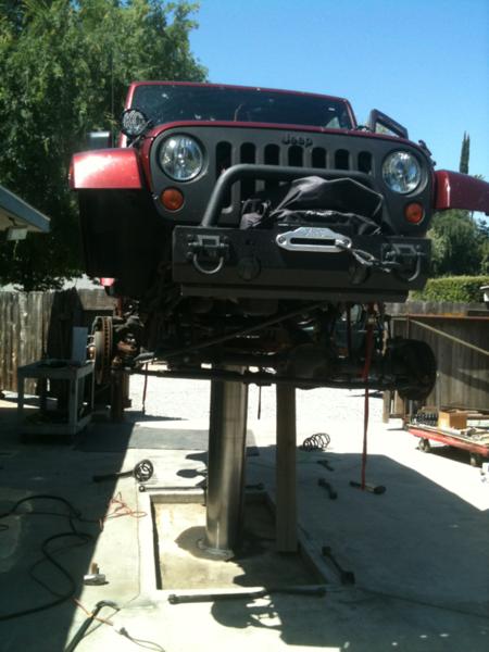

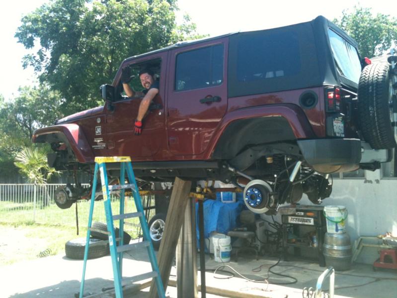

I did everything similar on that list, except the last 3, with my brother-in-law on a pneumatic lift in under 4 hours with a lunch break. Coils, shocks, trackbars, bumpstops, control arms, etc.... its really a piece of cake when you have the JK lifted high.
Having a 2nd pair of hands definitely helps. Good luck on the install and have fun!!

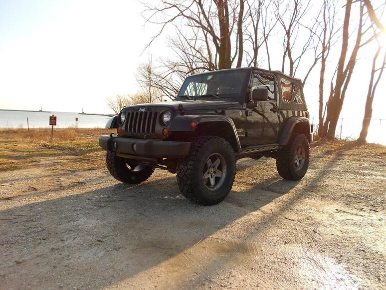

So we completed the install last Saturday, and it took about 8 hours to complete everything. The install was pretty straight forward... at least for a bunch of guys who didn't really know what we were doing!
I think it rides better than stock now that we got all the alignments dialed in!
Having a lift and pneumatics available also really helped things out!
