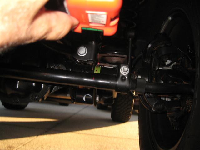

ID:	571007If your kit includes an adjustable track bar and you plan to re-center your axles, I used a laser level against the side of the crash bar for the front and a flat, repeatable spot in the rear (can't remember which) and marked the point on the axles with a piece of tape and a sharpie before install. This gave me the factory center point which made it very easy to re-center after the install.
Edit: Add pic.
