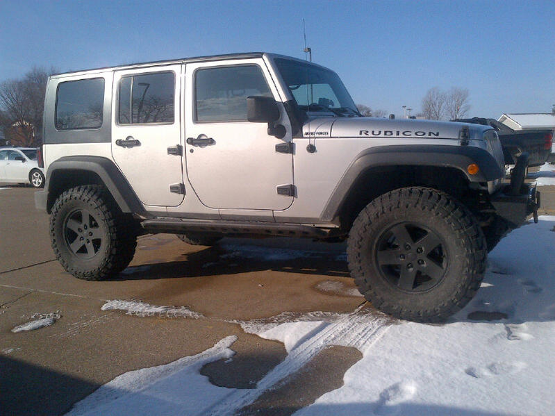

what size tire do you want to run cuz if your not running 37+ then there is no need for a 4" lift you will start to run into all kinds of issues once you get over 3.5 AEV has a good kit with everythin you need to make it right but i believe it is over $1500 I ran a 2" JSPEC with 35's and it worked great
<img src="https://www.jk-forum.com/forums/attachment.php?attachmentid=442242"/>

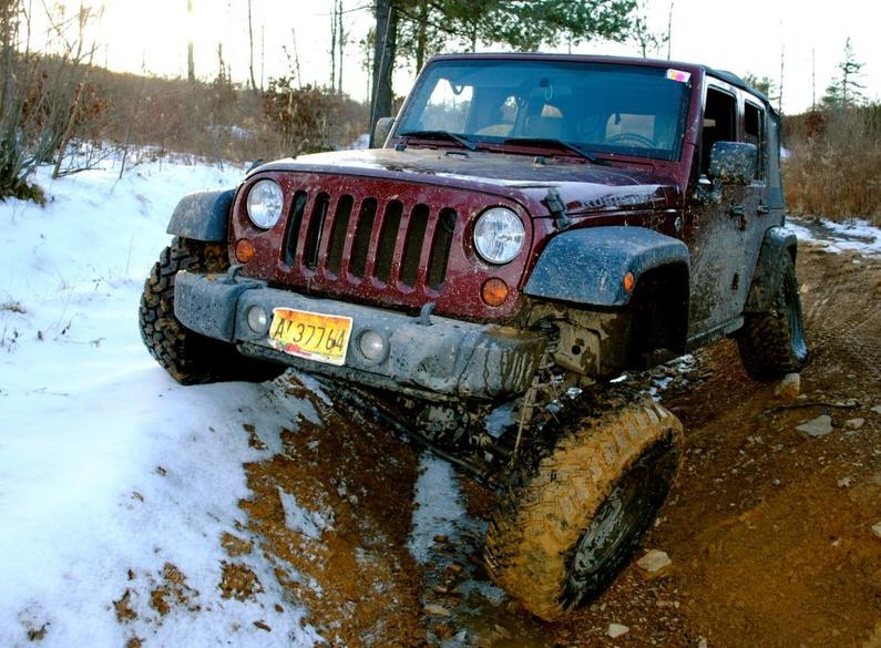

Rock Krawler 2.5 Flex with 35s for your decision making pleasure.
