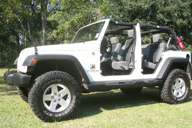

In fact you could go with a 2.5 BB, which most dealers are calling a 3in lift and not change anything. most people run their stock shafts just fine with a BB .Larger tires are what calls for re-gearing, depending on what you have now.
Old Feb 19, 2008 | 08:33 PM
mkjeep's Avatar
Posts: 15,665
From: Hammond Louisiana
Originally Posted by jeep07
Want to run 33" tires, 2 dr wrangler x 2007. Full traction 3". Who makes the best likt kit 3" ??? Thanks
Do a TFBB or an REBB and you'll run 33's just fine, if you wanna extra inch do a more 1in body lift. Here's mine with a RE2in BB and a more 1in BL
And it's with 35's
