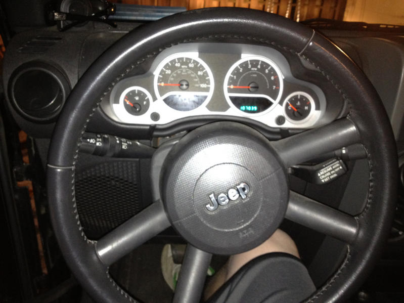

I centered my steering wheel after I installed my lift. The tires were straight and the steering wheel was perfectly centered when I was done. The ESP would always activate prematurely on sharp turns. It eventually got annoying enough that I bought a procal to find the true center per the ecu.
It hasn't prematurely engaged since. Here is a pic of what center is with the tires straight after 3" coils.

Well I took it to the shop and was told the steering wheel was centered. So I guess my next step is to buy a superchip and flash the ecu.
