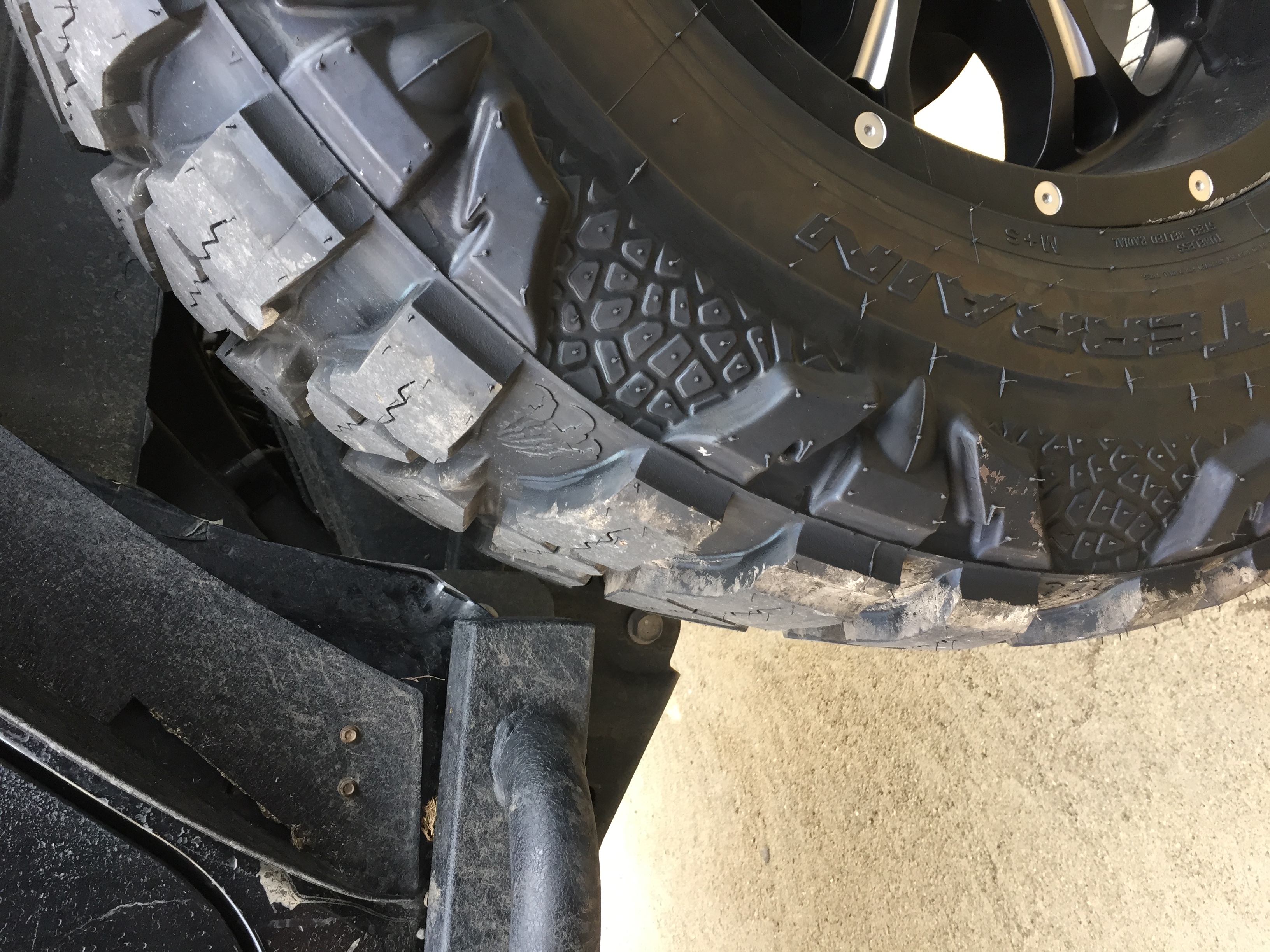

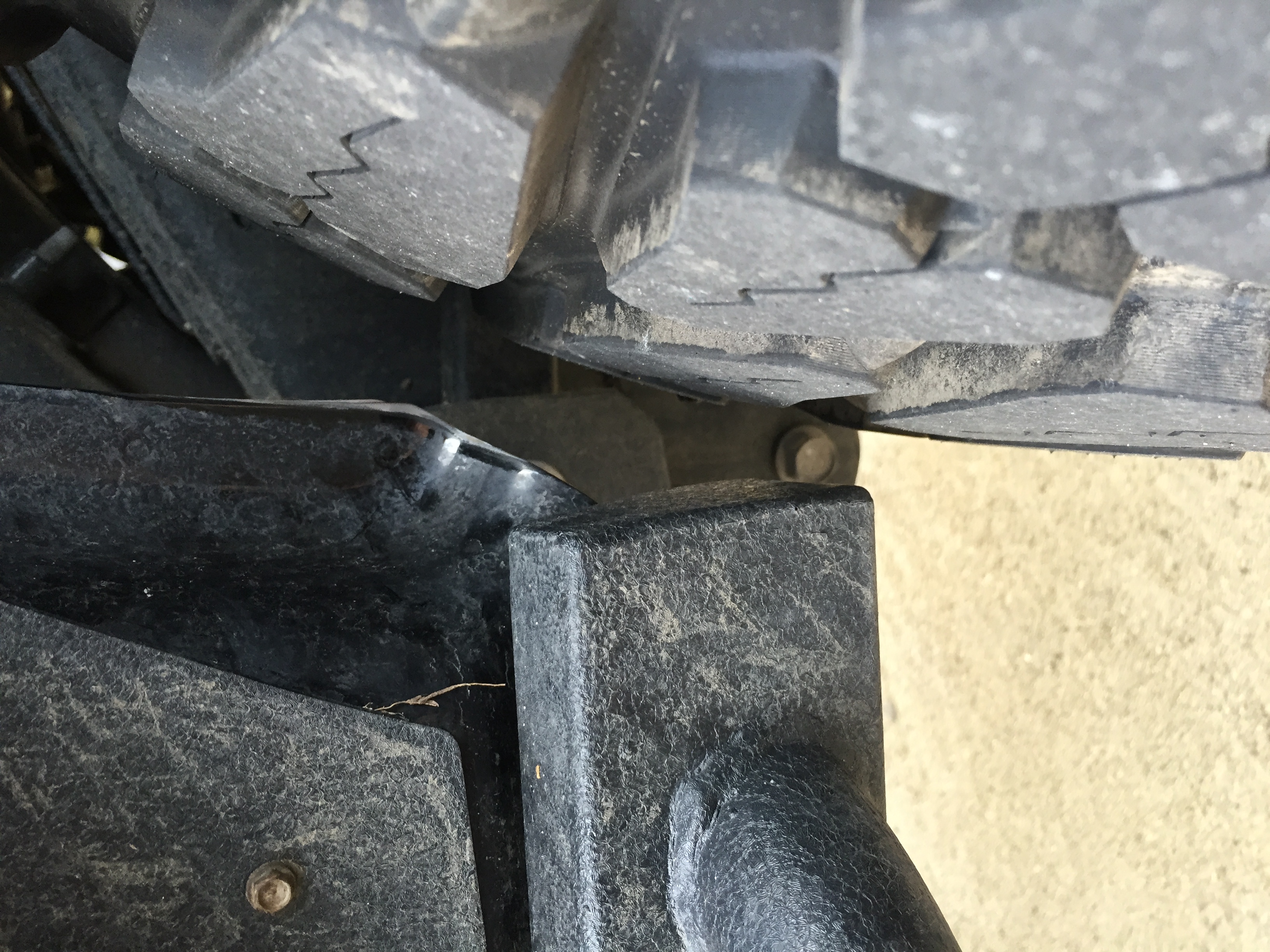

So I have what I was told was a 3.5" Pro Comp Lift Kit but when I checked the rear springs it appears to be 2.5" Lift. Anyways I decided to mount up some 37x13.5x20 Nitto Mud Grapplers and I expected some rub but now that I want to take my rig crawling rub isn't acceptable. My tires sit too far forward in the rear wheel well so when I hit any decently sized bump the pinch seam slices into my tire. So I have done some research around here and other sites and I know that getting a 1.25"-1.5" body lift if it would help improve clearance. I was thinking of also getting adjustable control arms, as I've read that would help center the rear axle in the wheel well. At that point id like to get the remaining long arm upgrade kit for my existing lift. But my question is, what else could be done in order to maximize crawling performance without breaking the bank too much. Instead of the BL lift and upgrade kit I would rather a 4" long arm full suspension lift if that sounds like a good idea and for a good price preferably. (Attached pics of the pinch seam with the 37" tires.

It depends on what your definition of breaking the bank means. A 4" long arm is going to cost a couple of grand plus you may be looking at some steering upgrades and driveshafts as well. I would say you would be looking at between $4-5k to properly go that route.
To keep what you have, a set of upper and lower adjustable control arms will let you push the axle back or you could simply do some more trimming on the pinch seam and rock rail.

Really all you need to do is trim that pinch seam and rock rail if you have flat fenders. I'd recommend trimming them anyways.
