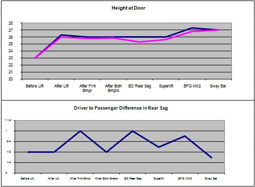

6)Lots of pics, but none that really show before and after results. The one below is current.
7)The actual lift depends on where the measurements are taken. I take measurements at 5 places along the frame (in case I mess one up) and track with various mods. The front went up 4 5/8", but back 2" on the initial install.
Below is the lift data. The first is measured at the door (each side), and the second is the side-to-side lean. Note the lean was there since day one. Wasn't until last week I figured out how to fix it.
