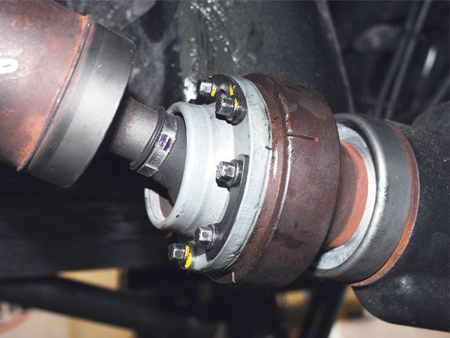

That's not awesome if you're on a budget. The more you angle the front driveline the more stress you put on the front cardan u-joint, near the differential/pinion. That will speed up it's life. Usually u-joints are pretty cheap $20, but on the JK's it appears they are about $100. If you go over 3", at least that's the number I hear thrown out, you can tear the CV boot on the drive shaft, near the transfer case. If you were to replace the driveshaft you would want to go to a double cardan type vs the Rzeppa factory type CV joint shown below.

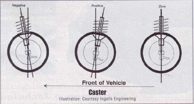

The further you lift up the shorter you wheelbase from front to back becomes. Also the caster gets out of whack. To overcome these issues you can install adjustable lower control arms (LCA). Some kits will also sell upper control arms, but those are less of an issue it seems. AEV also makes a corrective brackets that lower the LCA. They should work with any lift in place of new LCA's. They would help with on road, but lower your ground clearance which suck for off-road.
