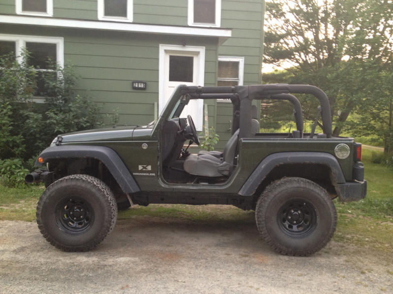

My 2 1/2 inch suspension lift lifted my bare-bones to door at least 3 inches so remember that to! that's what I have 33's on my truck
And under full articulation I can still stuff my back tire into my stock flares I wouldn't want to be any lower
If you go any higher you're going to spend quite a bit more money. And my old boy off roads just fine . Can't imagine where I've ever need to go he wouldn't bring me
