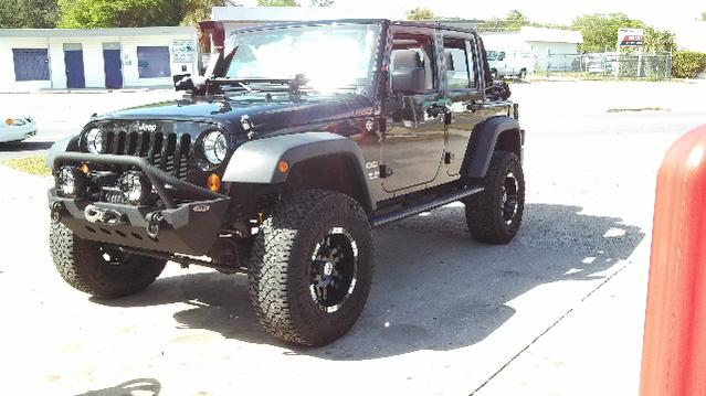

I went with the RK 3.5 mid arm flex, quiet as a church mouse and rides better and smoother than stock. Oh yeah and Blistein 5100's.
