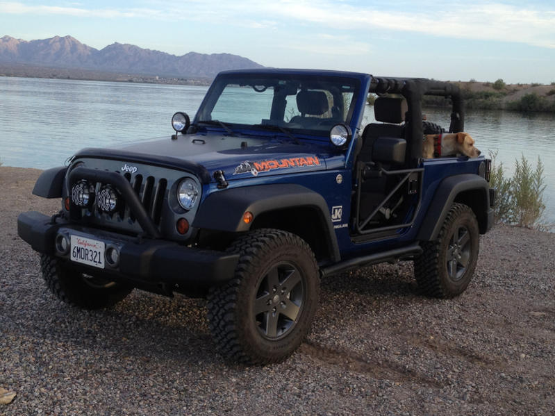

I have the Teraflex performance leveling kit. It's a great kit and the jeep still has that stock ride. I love it! It will cost you a little more than the economy leveling kit but I don't think you'll be disappointed.
