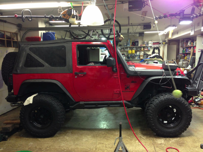

I know I was going to take some, as far as I can tell the axel should be centered measured with the tires on picked two spots and measured from the frame they are pretty close with in a 1/16 of an inch. So unless my frame is bent or isn't the same size that shouldn't be a problem, sway bars are in and adjusted right. Axel seams square under the jeep
First pic is it not leaning

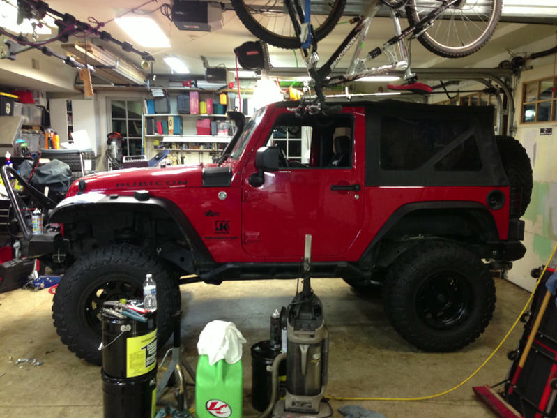

This is the side that is leaning and it's about an inch lower than the other side

Plenty of people experience the JK lean....myself included. Let me start off by saying that the gas tank has nothing to do with it. My JK had a 1.25" lean to the passenger side, and corrected it by installing a 1" Teraflex spring spacer on the front passenger spring....no spacer was needed for the back. This $20.00 item corrected my lean 100%

Man it could just be the picture but it looks like you have more of a lean issue up front than you do in the back.
