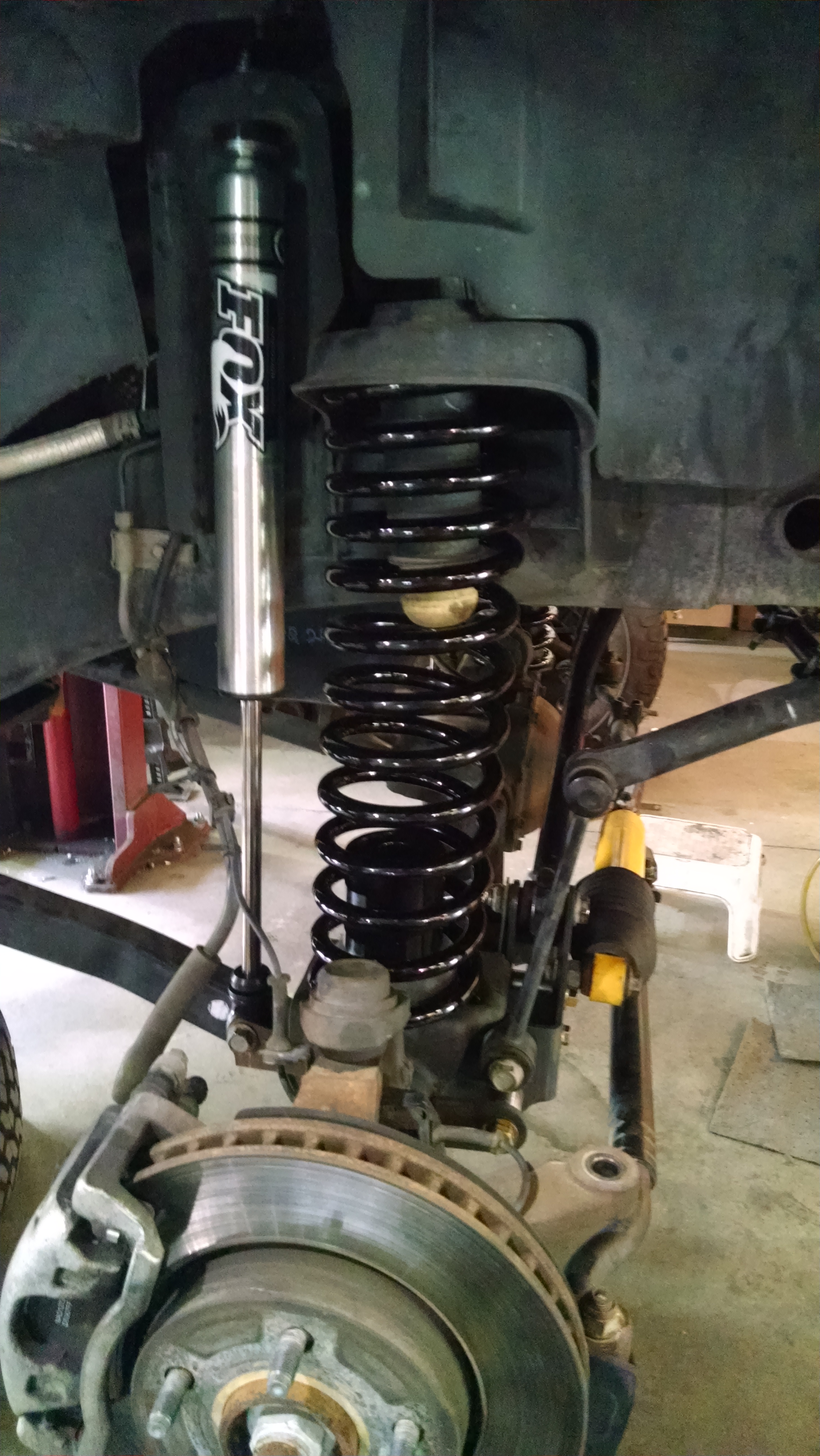

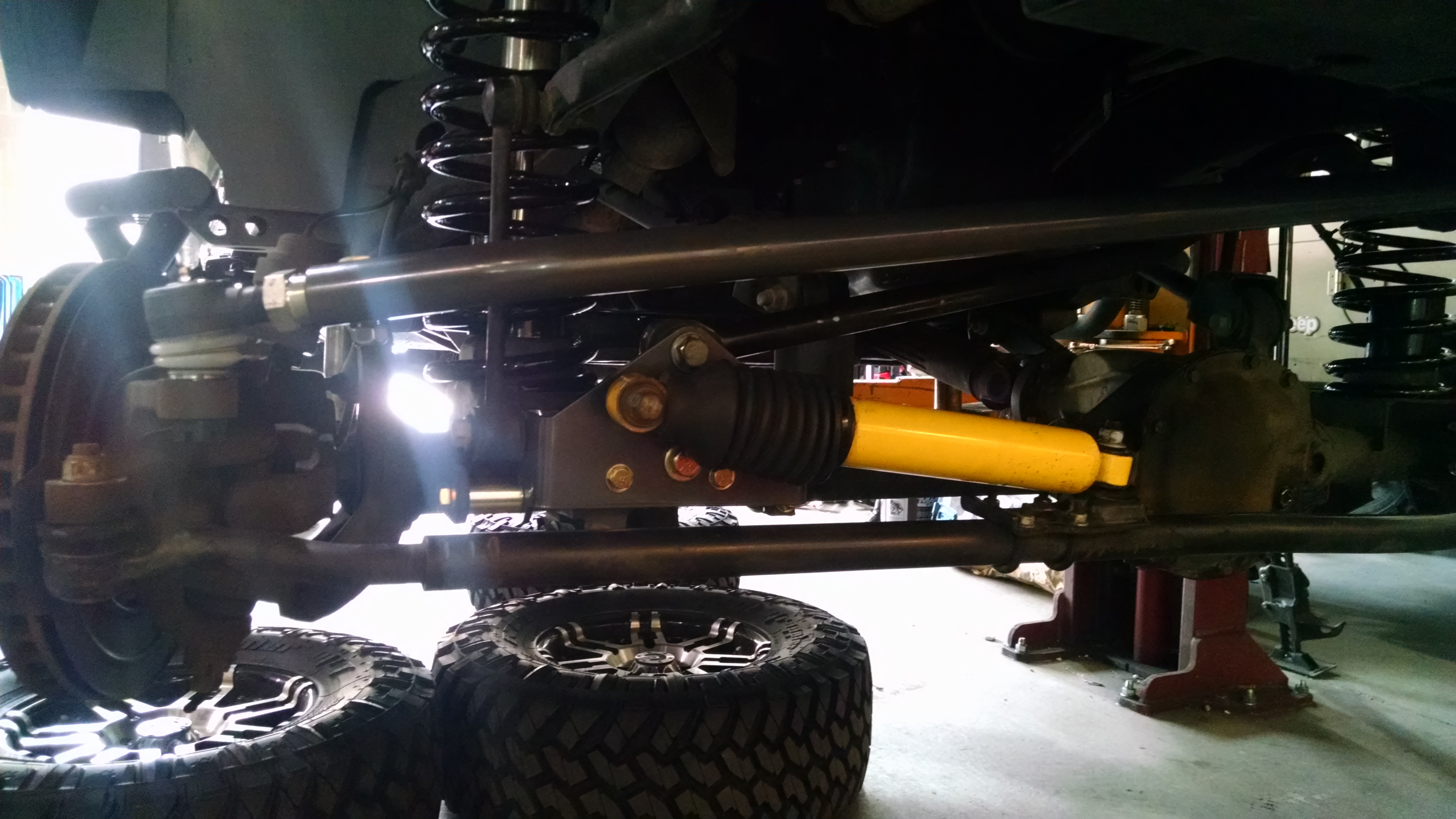

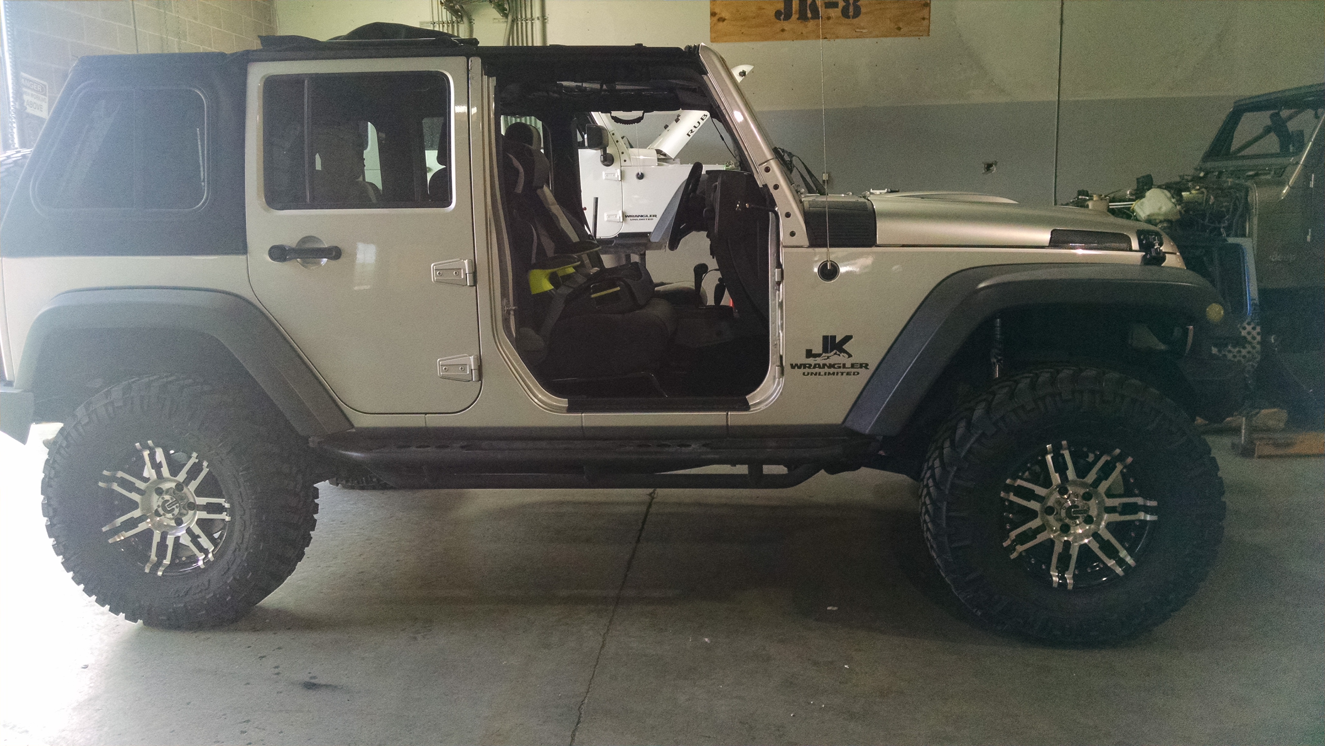

Yes, I do. Here's my story:
I had a Rubicon Express 2.5" Coil kit, OME Nitro shocks and OME stabilizer in my 09. I absolutely hated the ride and the handling left a lot to be desired. After a ton of research, debate and then a long conversation with a top notch shop, I decided to go with the JKS 3.5" progressive springs and Fox Evolution 2.0 shocks. We also did a DL flip, added a Synergy HD drag link and JKS control arm correction brackets. The difference is unbelievable. Even though I raised my center of gravity, the body roll is significantly less. There are no words for how tight and responsive the steering is. I had bump steer issues that now, even with the same stabilizer, are completely gone. Before, I could feel every little crack in the pavement. Now I can hit RR tracks at 50 and barely feel it. It rides like a Cadillac in comparison to what I had and the stance with my 35's is killer. Three of the guys drove it and couldn't believe it. One of them was actually really bummed that it handled better than his with the EVO/King setup and decided then and there that what I had was going to be the base for his next build. Keep in mind, I know these guys well and it wasn't just the typical blowing-smoke-up-the-customer's-ass-to-make-them-feel-good BS. If it was still shit, they would have told me.
We all use our Jeeps differently and are all looking for different things from our build. What's right for me may not be right for you. For me, this was right. It transformed a Jeep I was on the verge of getting rid of because I just didn't enjoy driving it into a rig you can barely pull me out of now.
P.S. The pics I have on my profile are of the old build. I'll have new ones up soon. Here are a couple in-process pics:
