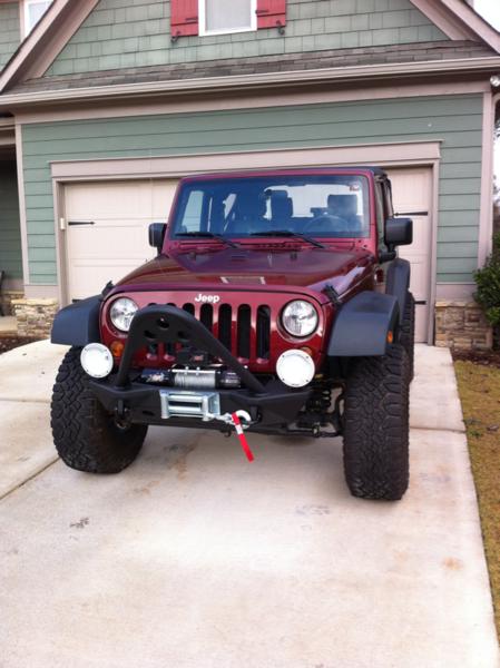

Get an OME HD 2" Lift. It's stated to be 2" but when you actually have it on you'll get 3-3.5" of lift. I have 35s on mine, I think it works well. I do get rubbing when I flex, but it doesn't bother me since I will be getting flat fenders.
If you have an auto and If you do anything more than 4" you'll run into driveshaft problems. Not good!

hah. after spending about another 4 hours looking around on the forums today. i think i might actually go with the OME long travel kit. it looks to have a little more of what i want. but im actually kinda confused to be honest. how did you get 3 inches of lift with a winch and a heavy duty front bumper? always something thats confused me about lift height.
Old Nov 25, 2010 | 04:43 PM
wazooz2424's Avatar
Joined: Sep 2009
Posts: 1,591
From: annapolis, MD
Adding bumpers and a winch will only cause you to lose about 1/4 to 1/2" of lift. A spacer will make up for that. If you want to stay inexpensive and something that requires little to no maintenance, stick with a 2.5" lift and maybe some flat flares. You can fit 35s and still do some wheeling with a leveling kit and flat fenders.
