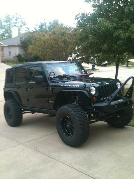

I have had teraflex 4" LCg running 37s Didn't notice the sag from bumpers and hardtop so it's not enough to tell/see. I've had lift for almost 1 year no problems here. And yes with 4" you need diff driveshafts and I would say yes in 3" due to seeing someone's factory cv shaft demolished and from what I hear he almost lost the jeep. I was told after while rubber in factory axle is mashed out due to angle and at 65-70 mph the metal welds together and I seen the shaft with my own eyes and not good at all.
Attachment 295496
Attachment 295498
Attachment 295499
Attachment 295500
Attachment 295501
Attachment 295502
You have the front bumper I want too!!! that thing is dam sexy!!!
