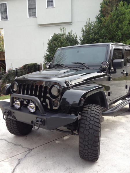

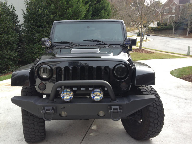

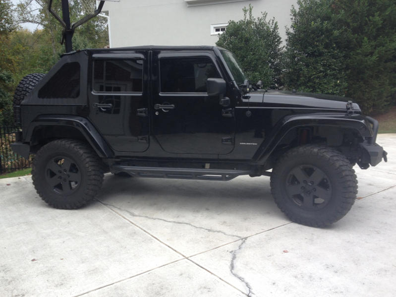

I'm not sure after the shorter sway bar links but I have a 2.5 inch lift and without the spacers my 35's rubbed bad at full turn. The whole jeep would shake bc of it and now that I run spacers they've been driving amazing for the last year. Hope that helps somewhat
