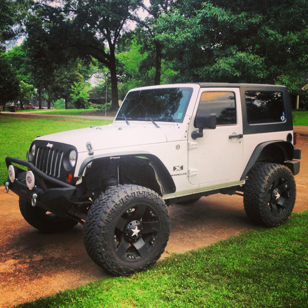

That's the problem my jk has a rough country it was on when I got it and its not to great
Here's a pic of it now.
