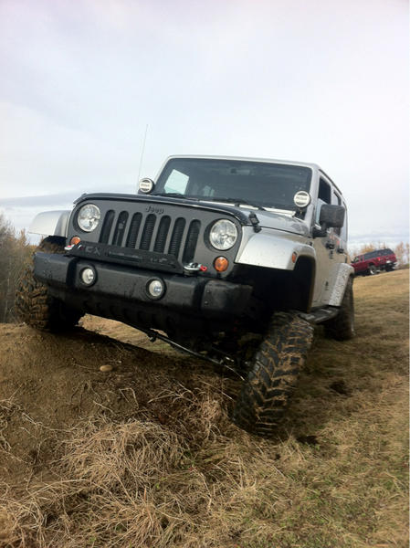

Here is my teraflex 2.5" BB w/ shock extensions. When disconnected it tucks the tire with about a 1/2 inch of room between the inner front fender and the tire. Daily driven, offroaded on weekends. Hope this helps.
