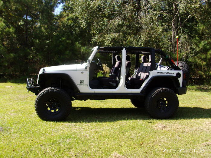

As john smack said, if you don't go crazy with coil spacers, you could lift accordingly aswell. Right now I'm running 4in superlift springs in the rear with a 1 3/4 in spacer and TF 4in in the front with a 1in spacer. Sits almost level.

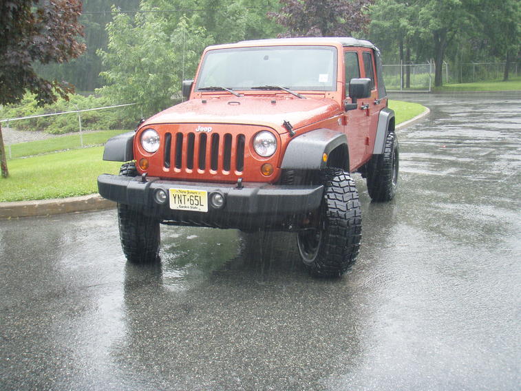

Here is mine now ....i was thinking i want to get enough lift to put 40's under this with a little room left in there....right now im running 35's
For 40's i would say you are going to need a 6" adn maybe a bit more. but 37-38's would work fine under my Jeep
