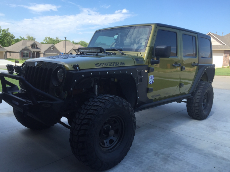

Alright I've got a 3.25" rc lift right now and that got the job done with getting me off the ground and I run 35's but will be upgrading to 5.13 gears w 37's when these tires wear out. Onto the meat of the question, what sort of lift should I be looking for if I'm using the jeep as a daily and I also like to hit the rougher trails (hard but not super difficult)? Another factor is I currently run the xrc fenders all around. (See pic)

If you want to upgrade, I would stay the same height and just get a higher quality company. 3-3.5" is plenty of lift for 37a. I run metalcloak and love it. Rock Krawler, terraflex, and synergy are other too notch companies. They all have a really fantastic product and even better customer service.
On another note, what does your current lift contain? Arms, brackets, TB, etc? Are you looking to only do springs, shocks, what components do you want to upgrade? Or are you looking to redo everything and get the most complete lift you can get?
