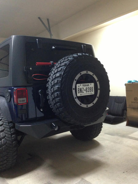

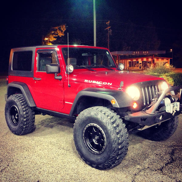

I have a 13 two door. I have driven the first 16K miles on 34's and the past 10K miles on 37's since purchasing new Feb 13. Most of my trips are 3-8 hours one way. I drove the first 24K miles on stock 3.73 gears and now I have 4.56. I also use the AEV Procal. Next week the 2" TF spacer lift will be removed and the 3.5" Game Changer will replace it.

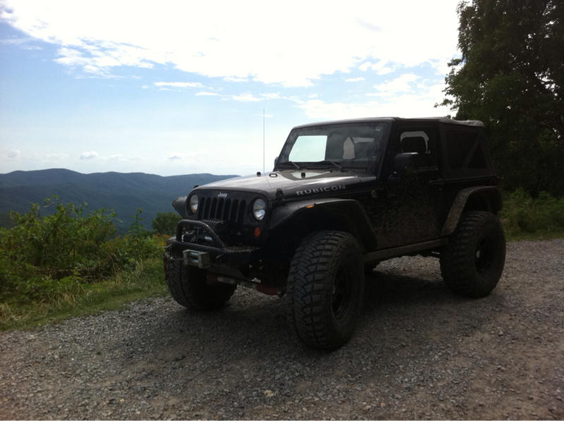

37x13.50R15's with a zone offroad 3" lift and xenon flat flares. It seems to drive fine for handling but had to remove the rock sliders due to rubbing over bumps and turns. I have a 1" body lift on order and trimming the sliders and pinch seams this weekend.

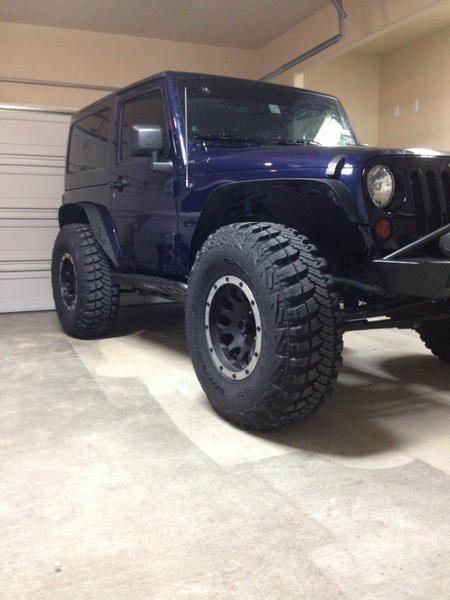

3.5 X factor. Great stability, ride, and looks

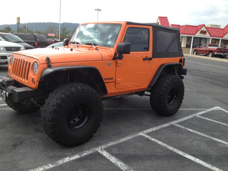

Sitting on 38's drive awesome on and off road!
4in bds short arm kit
