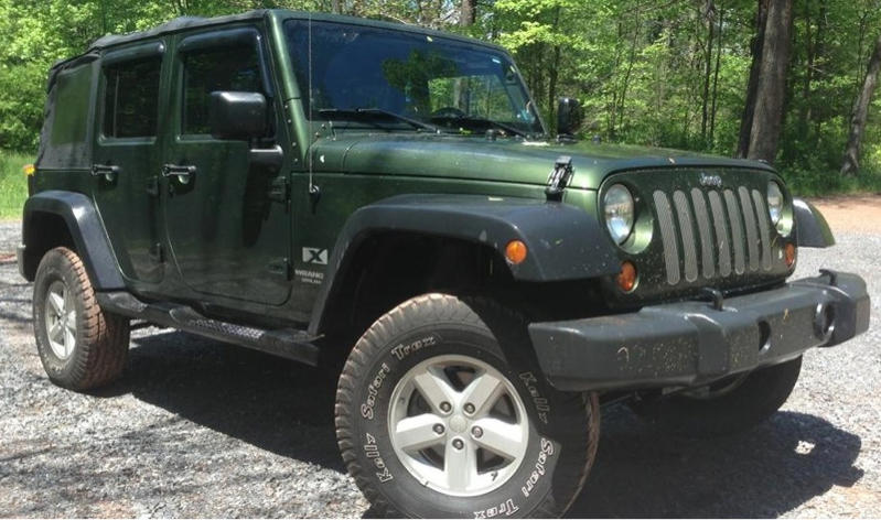

I just bought a 07 unlimited x 4dr and it had 33" on it and I noticed I sit up higher than most jeeps; including Rubicons. I didn't know if its possible the guy before added a small body lift or if the tires made that big of a difference. If you could look at the pic. Sorry if this is a dumb question.

Could have a small budget boost or just a set of tires. It doesn't take much to sit higher than a stock jeep.

Thank you for the response. I parked beside a rubicon with 33" tires and I sat about an inch and a half higher.

yeah it does appear to have some kind of lift

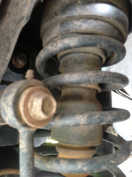

It doesn't appear to have a body lift. Look above the coil springs and see if there is a small(maybe 1") puck in there. Or just take a picture if ur not sure.

Pic would help. If it's a 1" puck it might be hard to see. Definitely looks like a suspension.

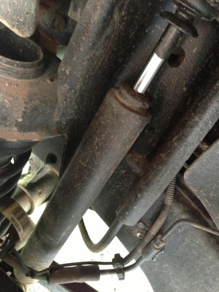

Here you go guys

Looks to be a spacer lift with bump stop extensions, extended sway links, aftermarket shocks. Looks like TeraFlex
