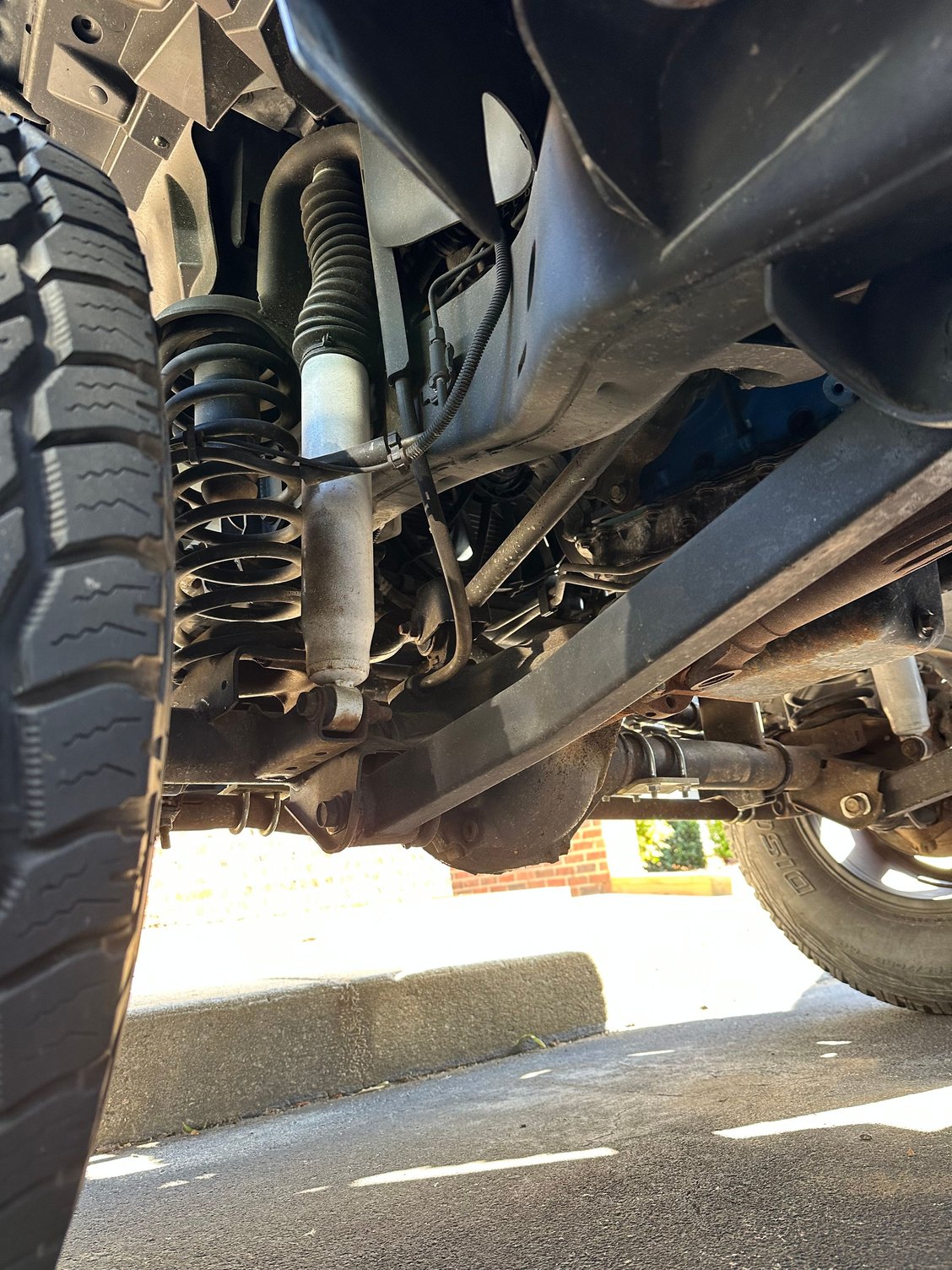

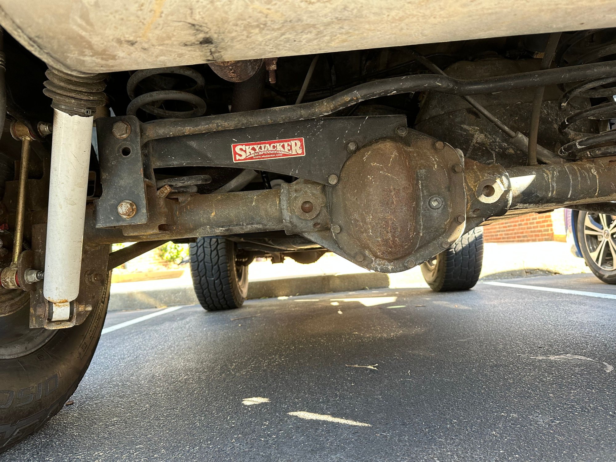

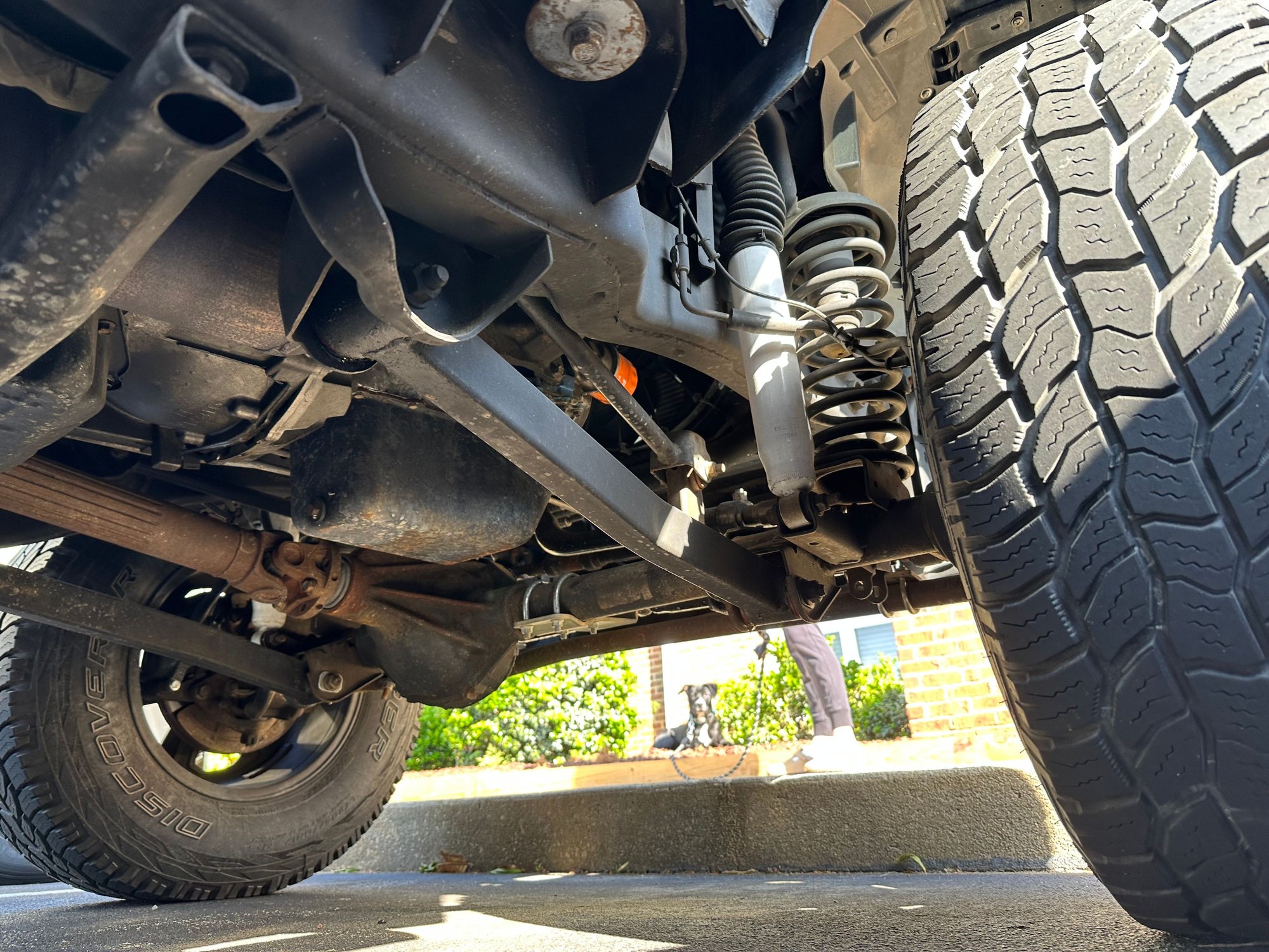

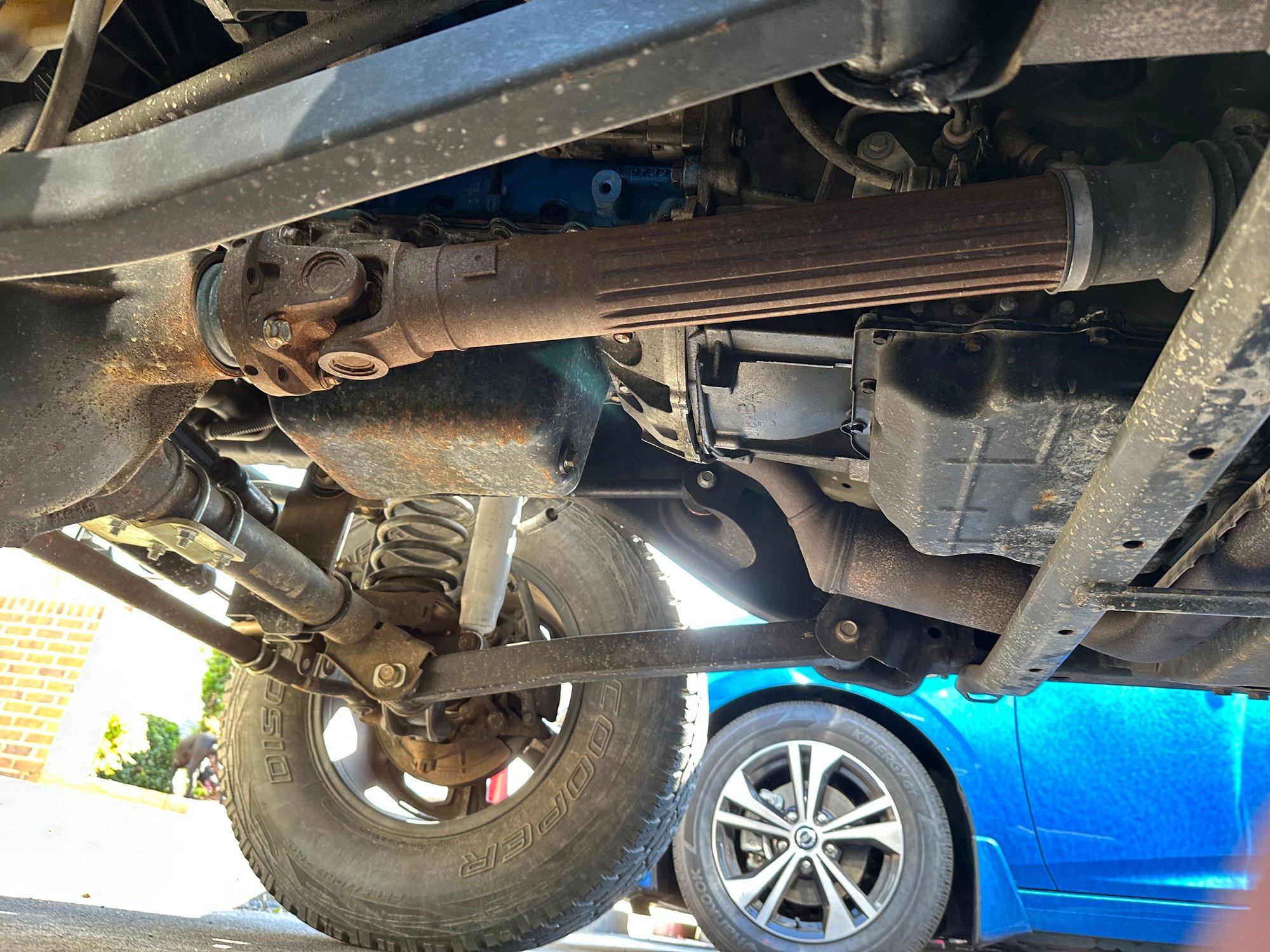

Thanks for the replies - I appreciate the help! I’ve attached some pics of the control arms. Let me know what y’all think.

y, you have zero caster correction right now. It looks like that front axle likely had cam bolts at one point cuz those metal rectangles under the bolts should be cam bolt eliminators to take up the hole the cam bolts needed. control arm brackets or adjustable control arms are going to be your path. If you don't plan to wheel in big rocks, there is nothing wrong with control arm brackets. Get ones that have multiple mounting options though if you go that route.
