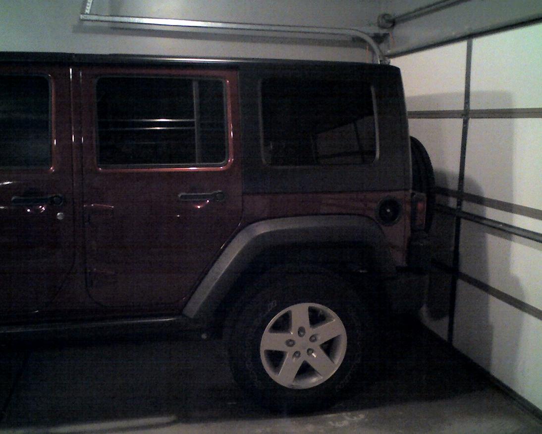

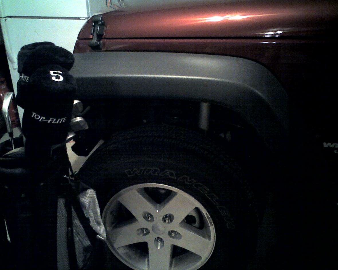

No, I did not order the Disco's, Track Bar's, or anything else - figured from what I've read I would go at it like this. I didn't even bother to do the fence mend mod on the back brakelines as there was more than enough slack for my current driving. However, there is enough room now with the lift that I can reach in over the tire and do it later which I'll probably do as a "just in case".
I did order it during the 24 hour sale a week ago and got an email with tracking info the next day!
Sorry, all I can post is crappie cell phone pics until I get my camera back.
The golf bag is there to hopefully provide a form of reference - I suck @ golf BTW!
The pic of the back shows I only got a few more inches to clear the garage door.
