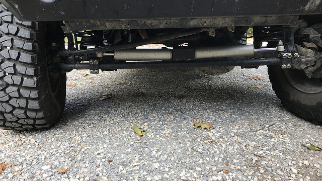

Both the brands I’m looking at come with one ss bracket, and they want $70 for a second one. I wonder if I could run with one of my two?

You 5000% don't need two. One is plenty.

I took one of my SS’s off and drove around without it and could tell no difference. Teraflex told me my lift didn’t include dual SS’s, I wonder why they added this?
