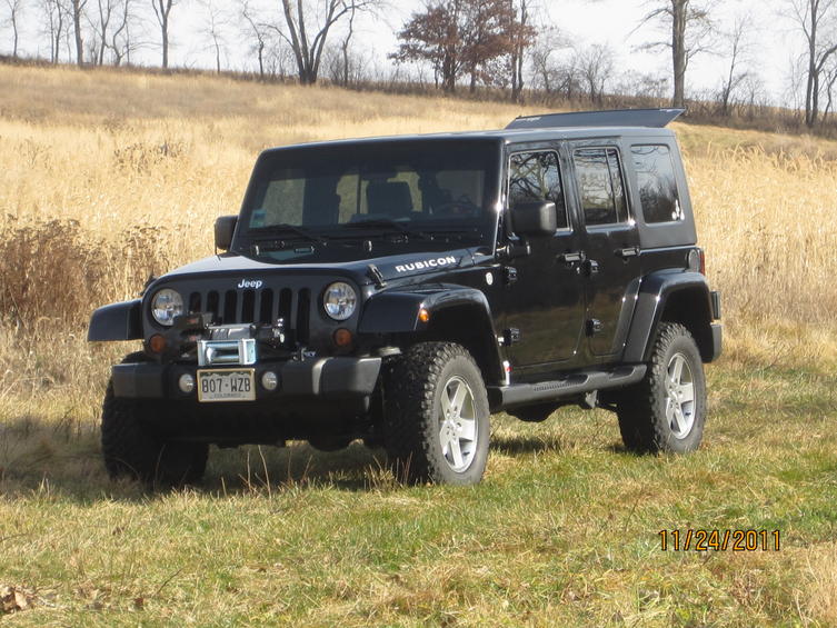

ID:	243097I just installed a RC 2.5" BB with RC discos on a 2010 Sahara with stock 17" rims and stock BFG 32" tires. No issues at all. Love the ride and no issues handling.
