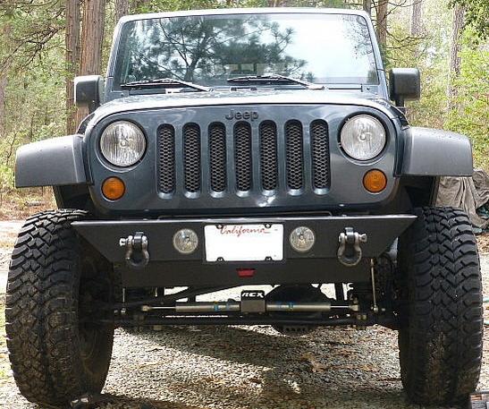

k0260's Avatar
Posts: 5,234
From: Nevada City California
Pavement Ends steel front bumper. Basic, Affordable, stout, light weight. EDIT: I was able to retro fit a Warn skid plate up to the bumper, fits peeeerfect
