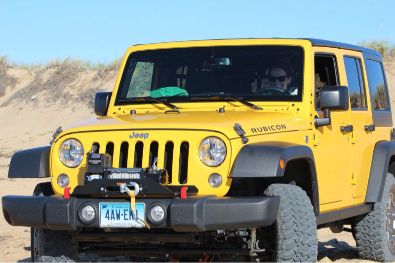

I just mounted the RockHard plate to the stock bumper... Don't have to move the vacuum pump, but the plastic screws on the grill air dam are a PITA.
Attachment 660191
You're right. I guess I should have said all winch plates that mount inside of the bumper.
