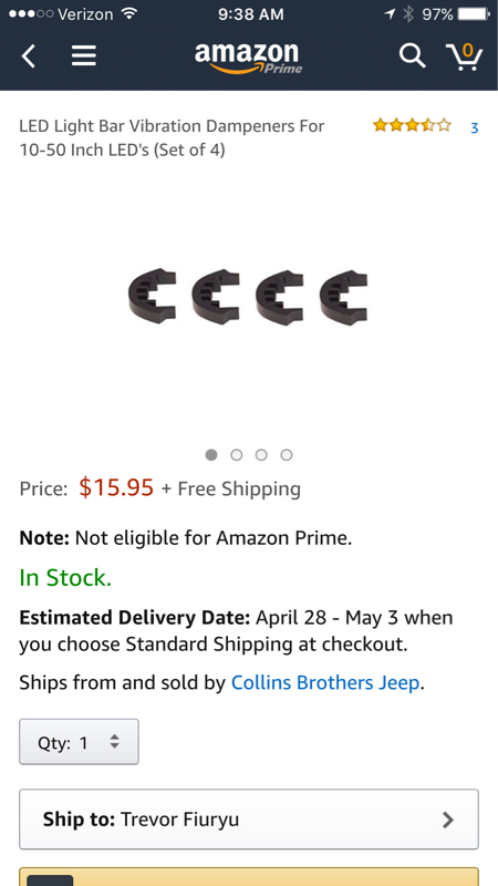

Or just get something like this. Some guys stated they did the trick. Light bar not at the top of my list yet.
