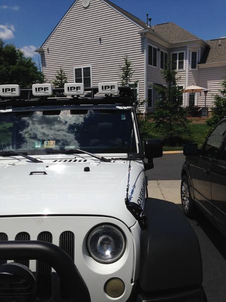

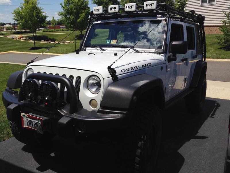

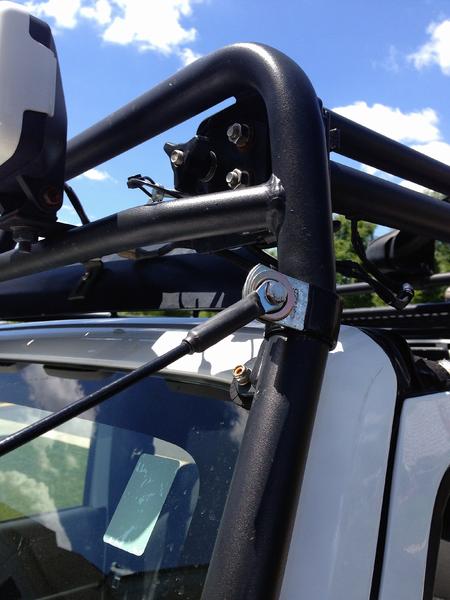

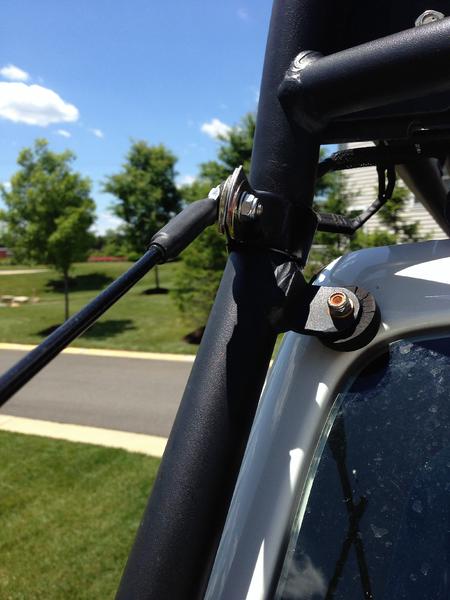

Here's the latest addition to the JK. Offroad Elements cables with Rugged Ridge latches and a Gobi Stealth Rack. Since the A-pillar plate from ORE won't work with the Gobi, you have to get creative. In this iteration (I have another idea I'm working on but I'm going to need a little bit longer cables), I used a couple of 1.25" vinyl coated hose clamps from an online performance racing shop and some extra bits (nylocks, bolts, washers, etc) that were in my tool box. Very happy with the result overall.

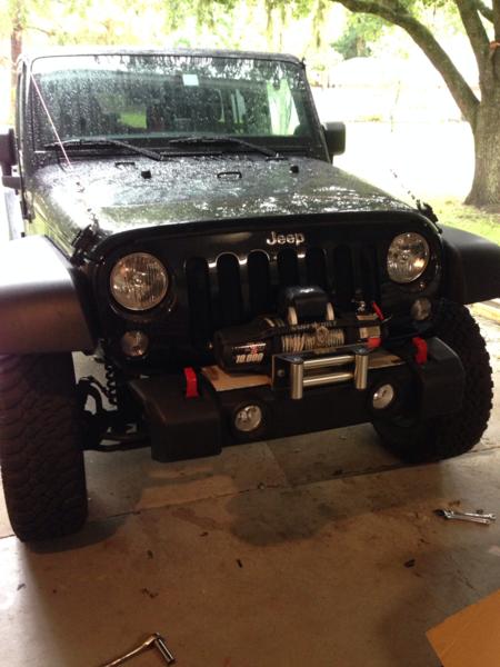

Looks great, welcome to the club. Just this morning I had two different people ask me what those cables do? I get that a lot as I am sure you will. Sent from somewhere I really shouldn't be!

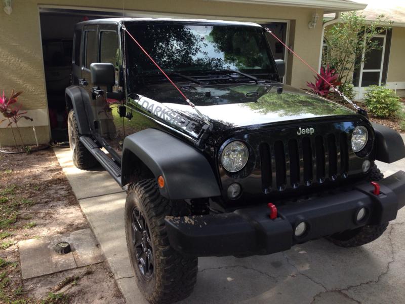

Awesome. Like the red cables. Works great on yours. "What are they for?", they ask. "Laundry," I tell them. LOL
Old Jun 9, 2014 | 12:25 PM
LordV8R's Avatar
Joined: Nov 2013
Posts: 323
From: Land O Lakes, Fl
thanks. I usually tell them that the windshield frame was loose. Lol! They work great, I made mine for 50$, better than buying a new windshield.
