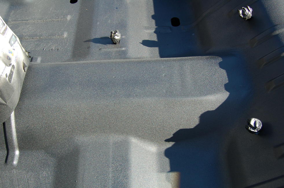

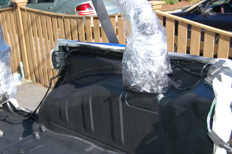

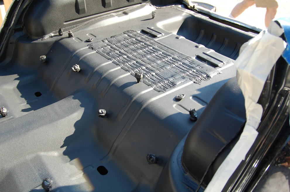

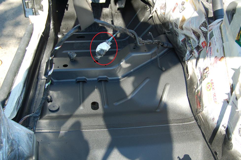

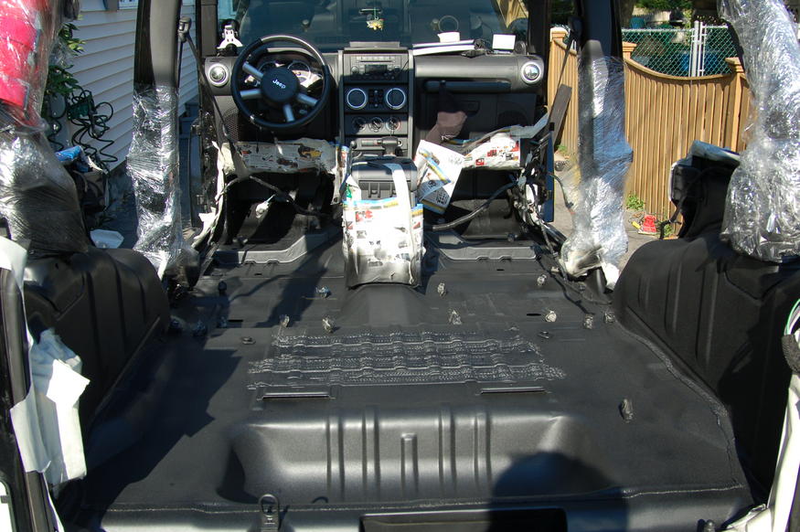

I removed all seats (4dr) removed the sound deadning material (except the rear as all i had was a screwdriver) Sanded it all down, Cleaned it up with acetone. removed the side trim peices and masked off everything else
also i used rustoleum bed liner instead of linex
