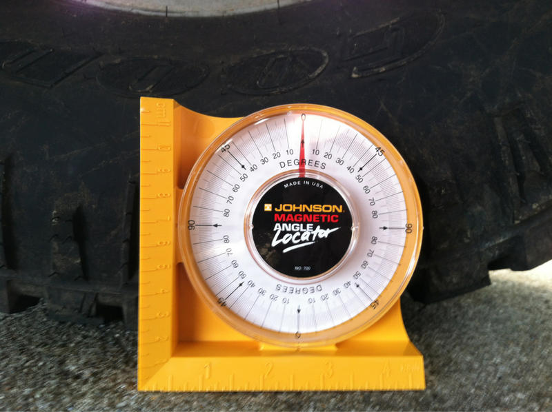

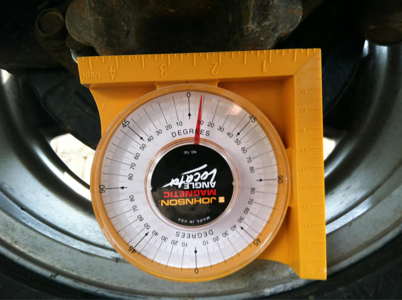

So I've got my RK 2.5 kit installed with lcas adjusted to 23 1/8 and I've developed some steering wheel shakes at and above 50 mph. I got an angle finder and measured on the lower C.

Based on the measurement on the C's I need to shorten my lcas. Is there somewhere else I should measure from? If so post a picture please. Everything is tightened to spec, just making sure I'm doing this right. Thanks for any input.

a speed related steering wheel shake or shimmy is almost always a tire balancing issue. even if you already had your tires balanced, i would try getting them balanced again. it's not uncommon for large off road tires to take 2-3 tries to get it right.

Wol, any suggestion on the castor? That reading appeared to me to be around 9*.. Shorten lcas?

try taking a reading off the top of your ball joint. if you are getting the same, you probably have a bit too much but, that would NOT be causing the shimmy that you feel. if anything, you might get some vibrations but, it would be a lite oscillating buzz that you feel that in the seat of your pants as well as everywhere else.

I feel a bit of a shake everywhere the wheel shimmys and I can feel the jeep shaking aswell.. Its at 45+ everytime. Not occasionally. The tires are internally balanced but if adjusting the castor doesn't fix the problem, I will be going back to the tire installer. And picture of how to get a measurement on the top of the ball joint?

again, a speed related shimmy is almost always tire balancing problem. too much caster WILL NOT cause a shimmy, just a lite vibration that oscillate - you can actually hear it. if that's what you're hearing and feeling and your caster reading is the same from the top of your ball joint, then yeah, reducing the amount of caster you have should help address this. if not, your dynabeads or whatever you have in your tires clearly prove they don't work.
