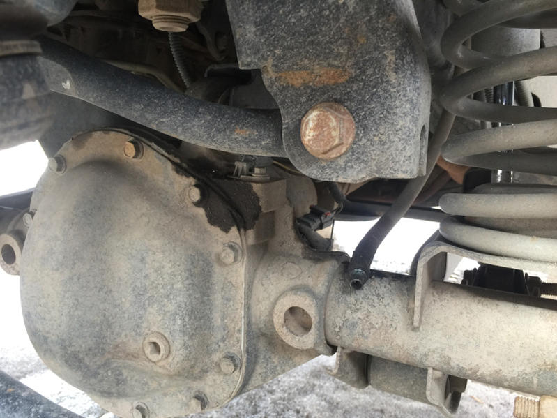

Can anyone tell me what the heck this is and where it goes?

That is your front diff's breather hose
It should connect to the top left side of your housing. Near your locker plug

That is your front diff's breather hose It should connect to the top left side of your housing. Near your locker plug
thank you sir!
