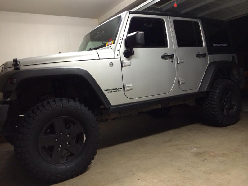

Here is my 2011 with a 3.5" rubicon express kit. I put the 33's on it and I needed a 1.5" wheel spacer to clear the rear wheels. The sway bar on the rear would hit the tire and you wouldn't be able to put the tire on at all.

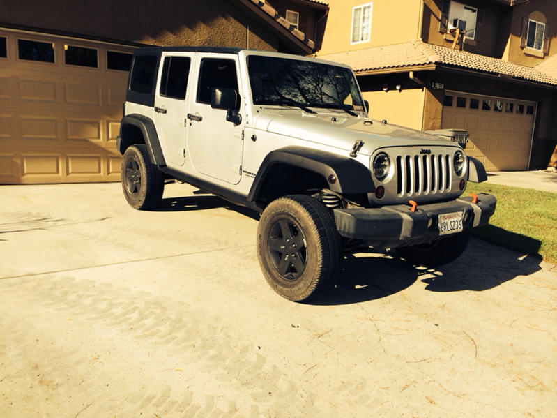

Also here's what it looked like with stock 17's and wheels. Still needed the spacers to clear the kit and tires.
