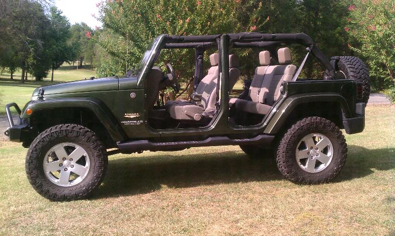

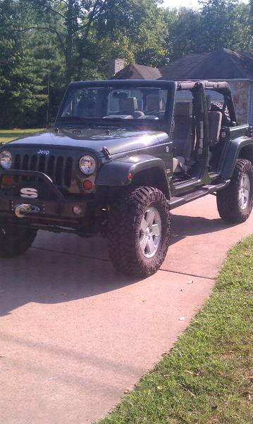

Here you go. It is a great kit for the money. It actually rides better than stock you would be fine with the hydro shocks for now and could upgrade them when they wear out. Like wayoflife said front lower control arms would be a good addition. I don't have them yet and don't have any issues but it is in the plans. I have had no issues with this lift and even after adding a bumper and winch it hasn't sagged much at all. As far as my front driveshaft I will run my stocker until it gives issues then swap it for a coast.
